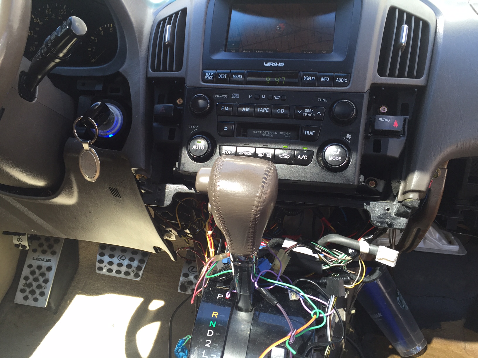

Picture1: Driver side lower trims cover plastic and Iron shield removed . Careful with iron shield very sharp use cloth gloves. Disconnect engine hood open cable, DLc & OBD2 plugs from the lower trim.
Picture 2: The fuse box need to unbolt nuts marked by red circle. Plugs need to unplug marked by Red arrow.
Picture 3: Blue arrow plugs need to unplug for steering column to be down.
Picture 4: Radio removed by taking out 4 nuts 10 mm circle green.
Picture 5. Remove the black bezel by unscrews 2 upper R/L side of the odometer. 3 Screws and 3 harnesses plugs need to removed.
Picture 6: Odometer removed. You can see Green Arrow where dash harnesses are and should be stay there.
Picture 7: Gear snifter assembly removed by lower and upper 4 nuts, 3 harnesses ( 2 upper R/L side and 1 lower right side).

Picture 8: Remove Gear Snifter cable from the unit by using flat screw driver red arrow. Green circle nut of shifter gear need to remove.
Picture 9: After you remove the CD changer remove 2 nuts and 2 bolts of passenger airbag, disconnect harnesses. Red arrow airbag plug.
Picture 10: Red arrow 2 nuts 10 mm bracket for ECU need to remove. Green arrow plugs need to unplug before Dash removal. Same thing driver side harnesses plugs need to unplugs and marked with labels.
Picture 11: Bothe side pillars L/R need to pry out and right side AM/FM antenna cable need to disconnect.
Picture 12: Harnesses, plugs removed. Red arrow.
Picture 13: Now wiggle and remove the dash. After you remove the dash, Blower motor assembly by removing 4 nuts 2 bottom by ac drain hose upper 1 and another by air duct and remove harness .Now you could access the ECU bracket at the passenger side and remove the nuts and black plastic cover. Remove 14 mm bolts red arrow, 10 mm bolts. Disconnect JB Box green arrow, Spring of brake pedal yellow arrow need to remove from the Reinforcement bar.
