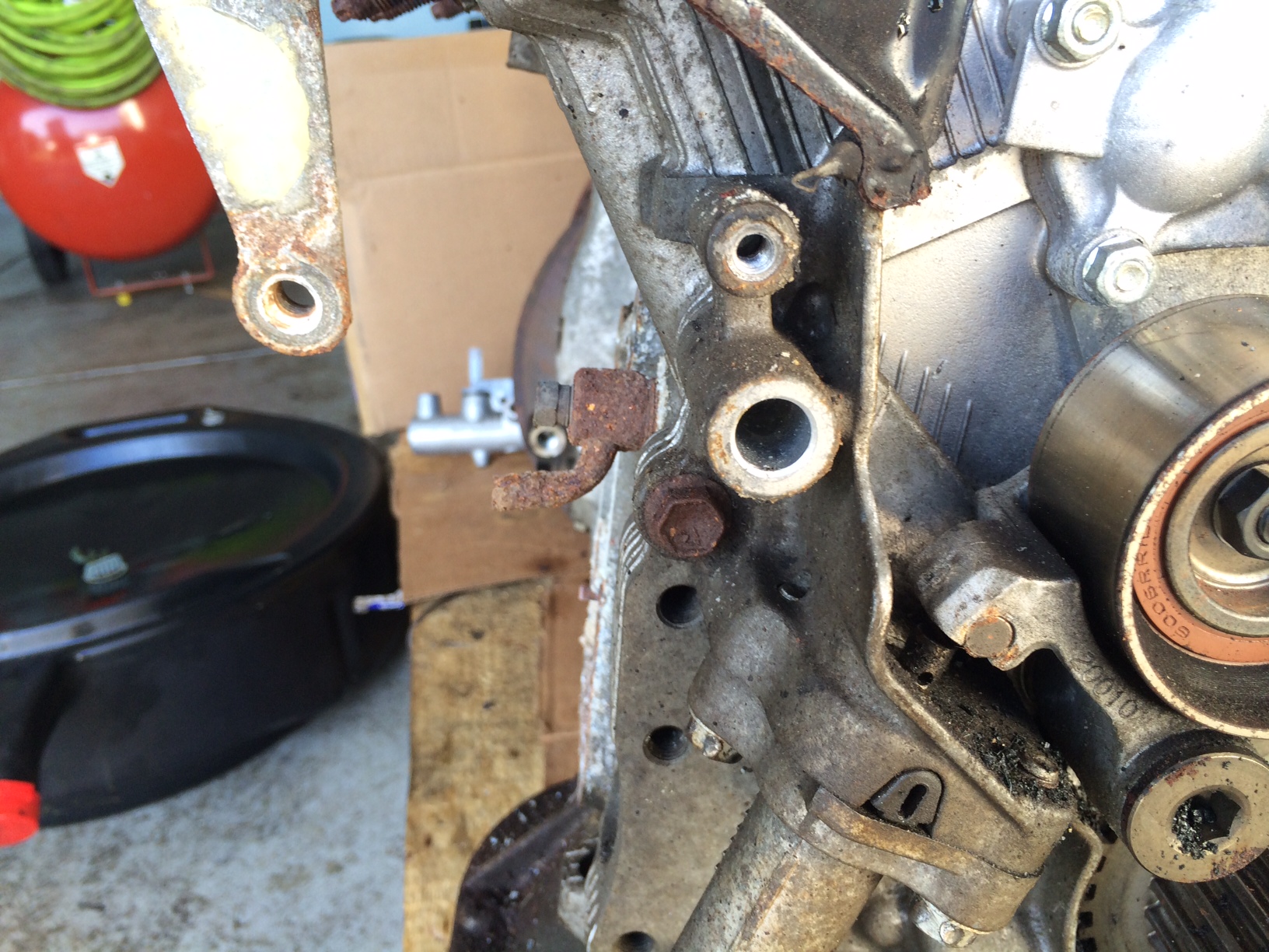

Here are the pictures! Took me longer to figure out how to post them that the engine swap!! I need to get with it. It's all associated with my google drive.
The first picture is the RX300 Oil Pump assembly on the blown motor. Pay careful attention to the location of the tensioner and tensioner pulley. Also the lower timing cover, by the harmonic balancer needs to be swapped over. The hole for the tensioner is in a different spot.
The second picture is the setup of the Highlander Oil Pump I removed
The last is the rear engine mount on the RX, it is IDENTICAL on the highlander. The only difference is the MOUNTING BRACKET. As you can see, the stain on the RX does not completely cover the mount but it does use all 4 holes. There is an alignment dowel. The Highlander matches it perfectly.
Attached Thumbnails 2003 RX300 Engine Compatibility-image_1.jpeg   2003 RX300 Engine Compatibility-image.jpeg   2003 RX300 Engine Compatibility-image_4.jpeg

Posts: 105
Here is the bolt that needed to be swapped over. It's for the power steering pump. The pumps are the same but the highlander mounting bracket is different. I cannibalized mine, kept the pump. In case mine goes, I can just buy a rebuild kit and swap. Kept the other A/C compressor too.
