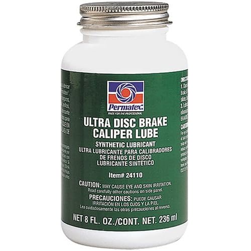

What kind of lube to use on the slider? Any specific one that will last a long time especially with snow and salt? Thanks.
Old Aug 8, 2010 | 09:09 PM
carguy07's Avatar
carguy07
Joined: Nov 2005
Posts: 2,110
Likes: 77
From: OH
I like this stuff:
