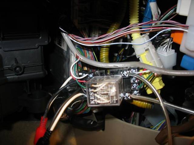

Not sure if this will help you or just confuse you more but here are some pics of my install:
As shown in the last pic, you need to slice open the thick gray wire and inside you will find the L+- and R+- wires.
