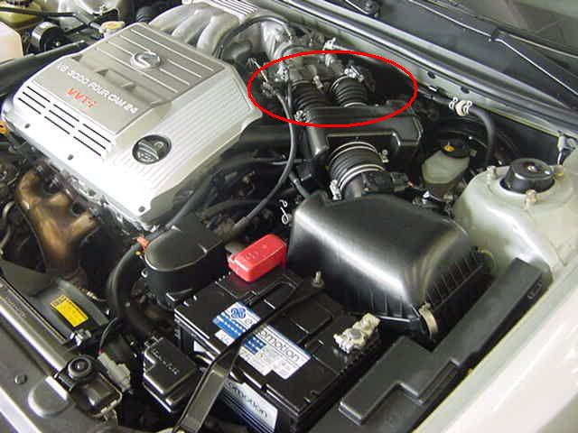

4. RX300's are have 2 throttle bodies. This is simply not true. I only see one.
The 1MZ-FE VVT-i versions have a larger twin chamber t/b design. The TRD S/C works off the 1MZ-FE single circular single t/b. Here are the differences between non-VVT-i and VVT-i t/b intake units on various 1MZ-FEs....throttle body and intake piping circled in red on purpose...
1MZ-FE VVT-i MCV20(99 ES300) twin t/b intake design:
