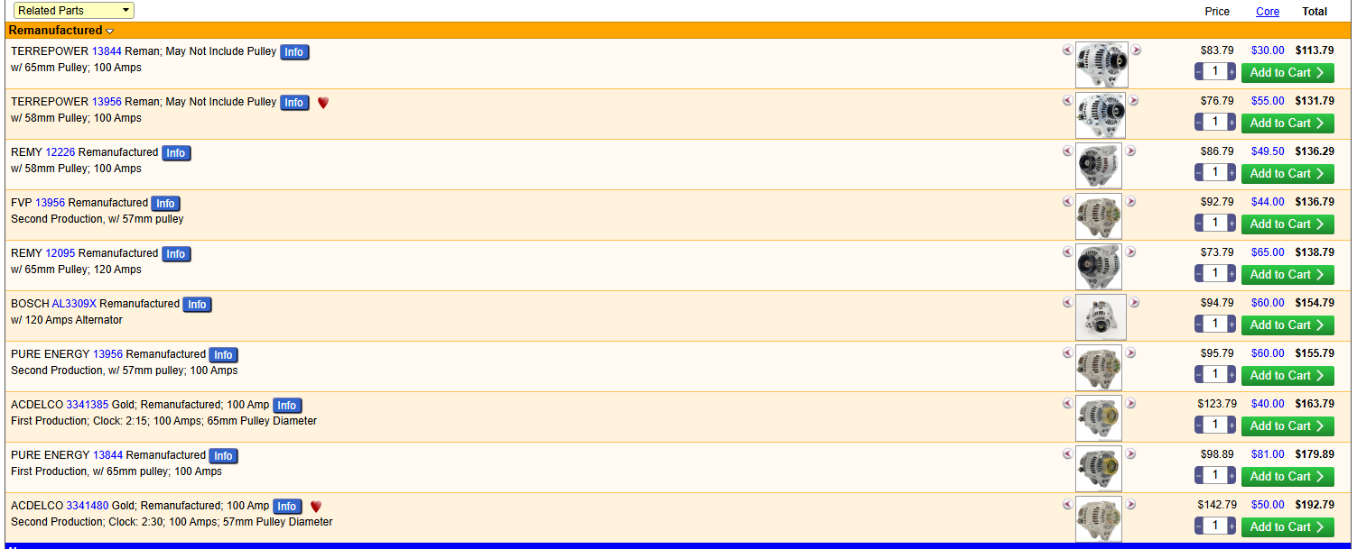

Old Dec 1, 2025 | 10:32 PM
hsmac's Avatar
hsmac
Joined: Sep 2015
Posts: 395
Originally Posted by Obscurations
Based off my research so far, its not worth it to repair a alternator, so nevermind on that.
Apparently Remy brand is a good reputable remanufacturer, and this is a good part for me. (If the current one is indeed clockwise rotation and close to 90-120 amps or something like that).
https://www.rockauto.com/en/moreinfo...t=2412&jsn=546 (Also dang that core charge is almost the price of the unit itself, sheesh)
But I should maybe also replace the belt as well and check the tensioner? It sounds like that could be part of the issue. Right now as of several months ago, my belt started squeaking for about 10-20 seconds on a cold start before going quiet, but that has been doing that for ages and I only noticed a hesitation last night so I don't think its the belt not powering the alternator properly.
I bought this car back in 2020 from a previous owner who said she took good care of it at a mechanics shop, so I do not know how old the belt is. Does anyone know if there is a date on the belt or something like that?
I was told that repaired stock alternator will be significantly better than any aftermarket
