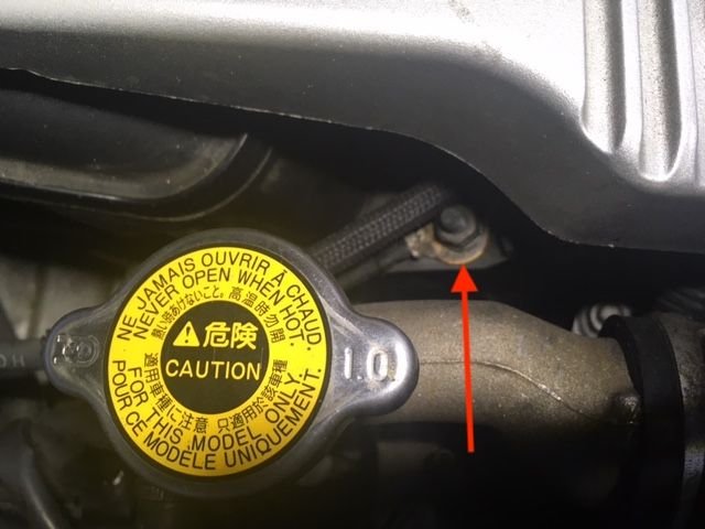

Did you disconnect the ground points when working on the dampener? If so, recheck those
These are for 2002 es
Did you disconnect anything from alternator? Check the two connections - the post connection AND the plug in connector

If grounds are verified and still no joy then do a compression check.

Compression check done a couple days ago and was great. Ground wires are Ll attached I rwn into thet before on a nissan murano and learned my lesson. Yea...plunger foe belt was reset out back in and.pin pulled to release it tk tighten the belt as book says. I'm hoping, that's all jve got left thst putting rhe iridium plugs and denso coils in it while do the trick. They'll be here kne day this week so sew soon enough
