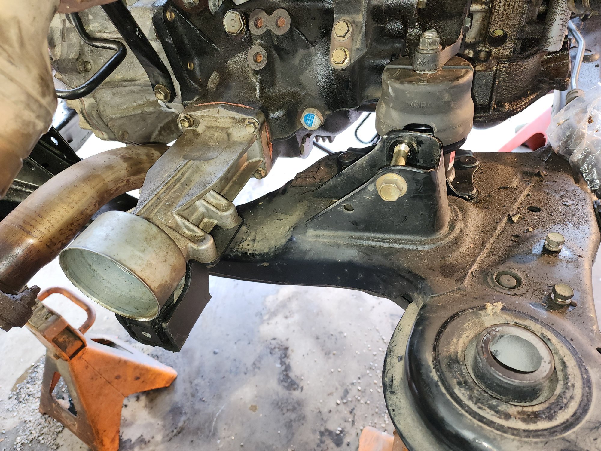

I just installed an OEM Lexus 1236120060 front mount, and the other three in Lexus.
Ebay $179.
1mz engines chatter at idle. I've read that aftermarket mount are so poor that tbey've been removed from tbe market.
I got the OEM Lexus front shock from UAE. Good price and it arrived within a week.
The 20060 mount is vacuum modulated for quiet idle.
Various Lexus and Toyota dealers offer deals online. Hendricks and Bells supplied mine.
If all things, motor mounts and seals are best as OEM.
An AWD RX has considerable weight stuck on the backside of the engine that an Avalon doesn't have. It might work as in "fit the holes" but it also could induce cabin noise and harmonics into the body.
UFm
If rhd part numvers are different, something's different.

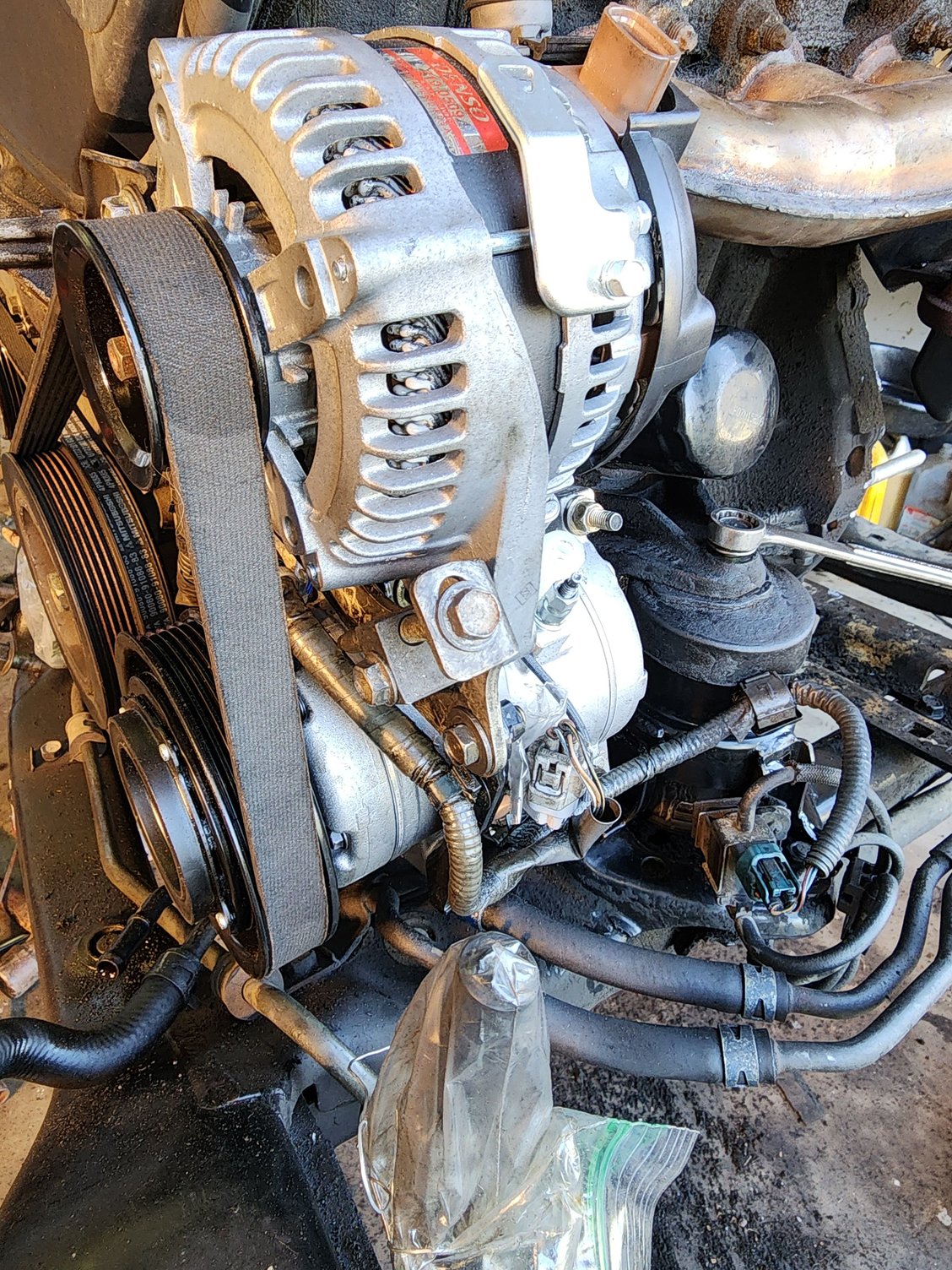

Unless collapsed, I'd leave the old mount in before going with aftermarket. Especially the rear mount. The front us easy to replace. The rear is not.
the rear pic us sans steering rack and sway bar.
