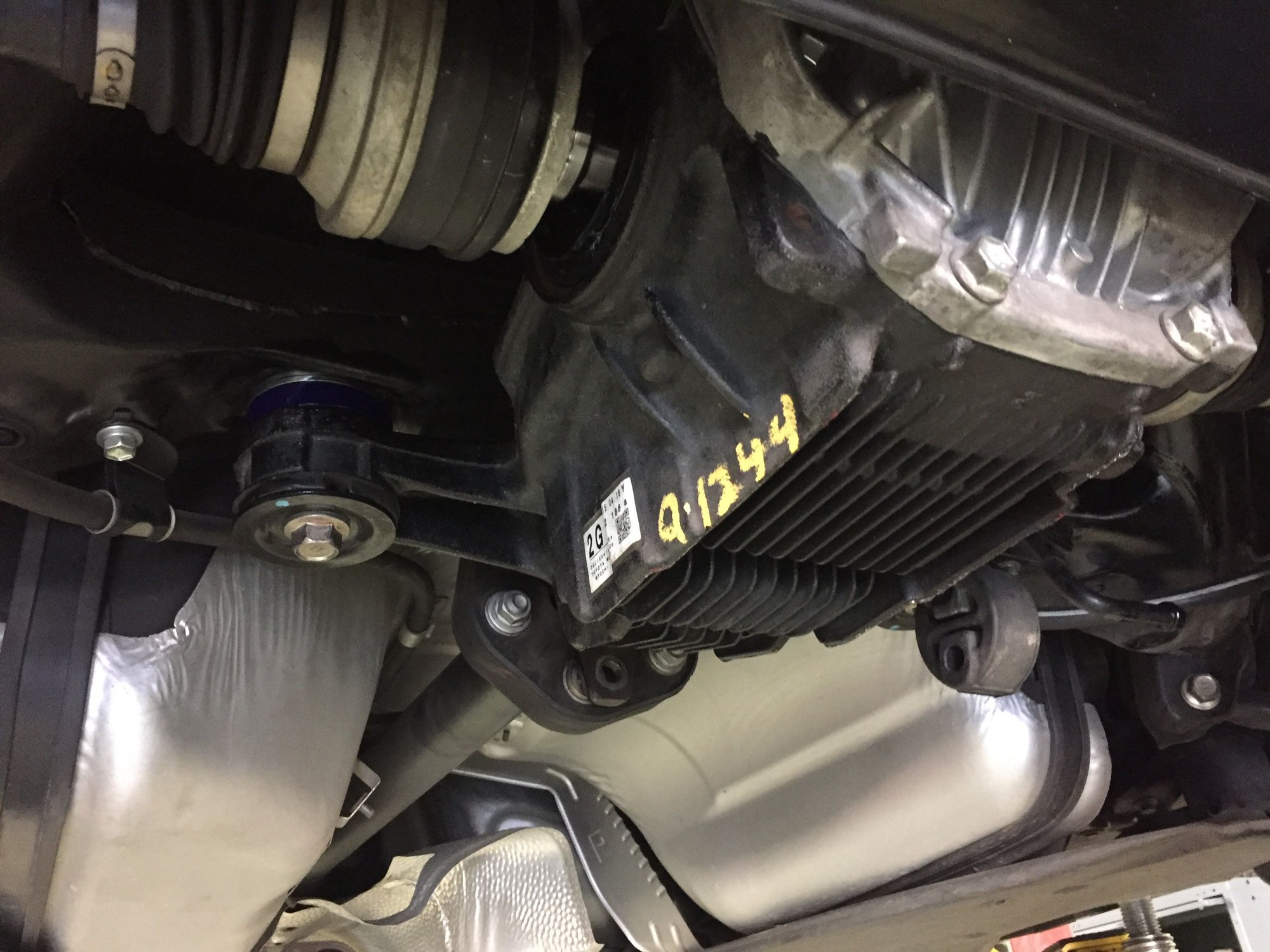

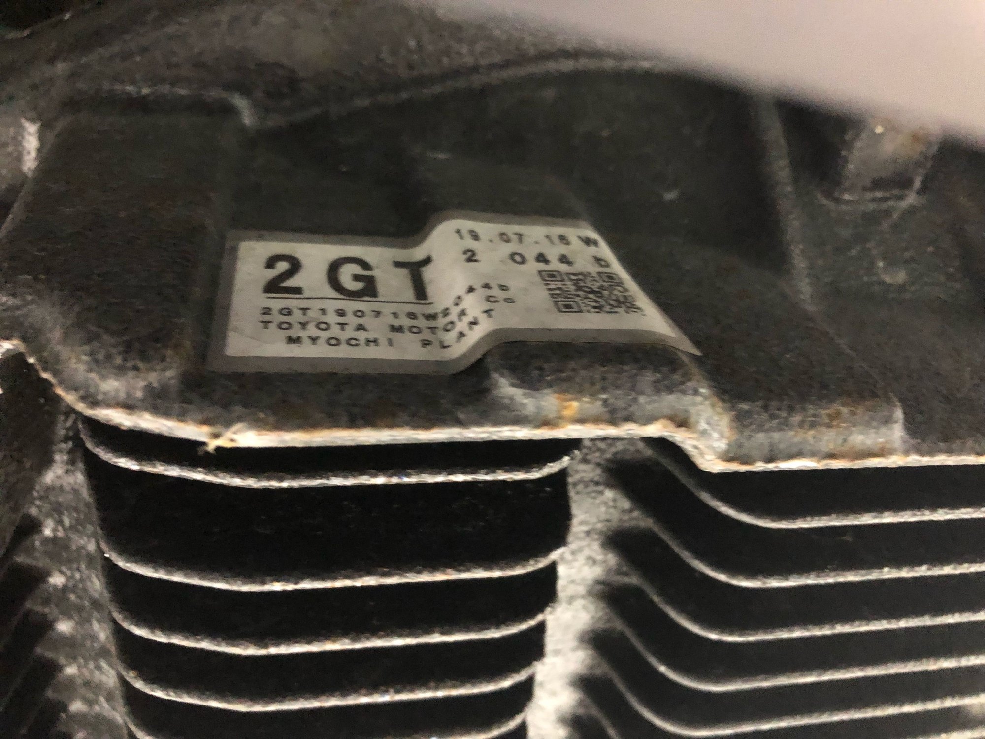

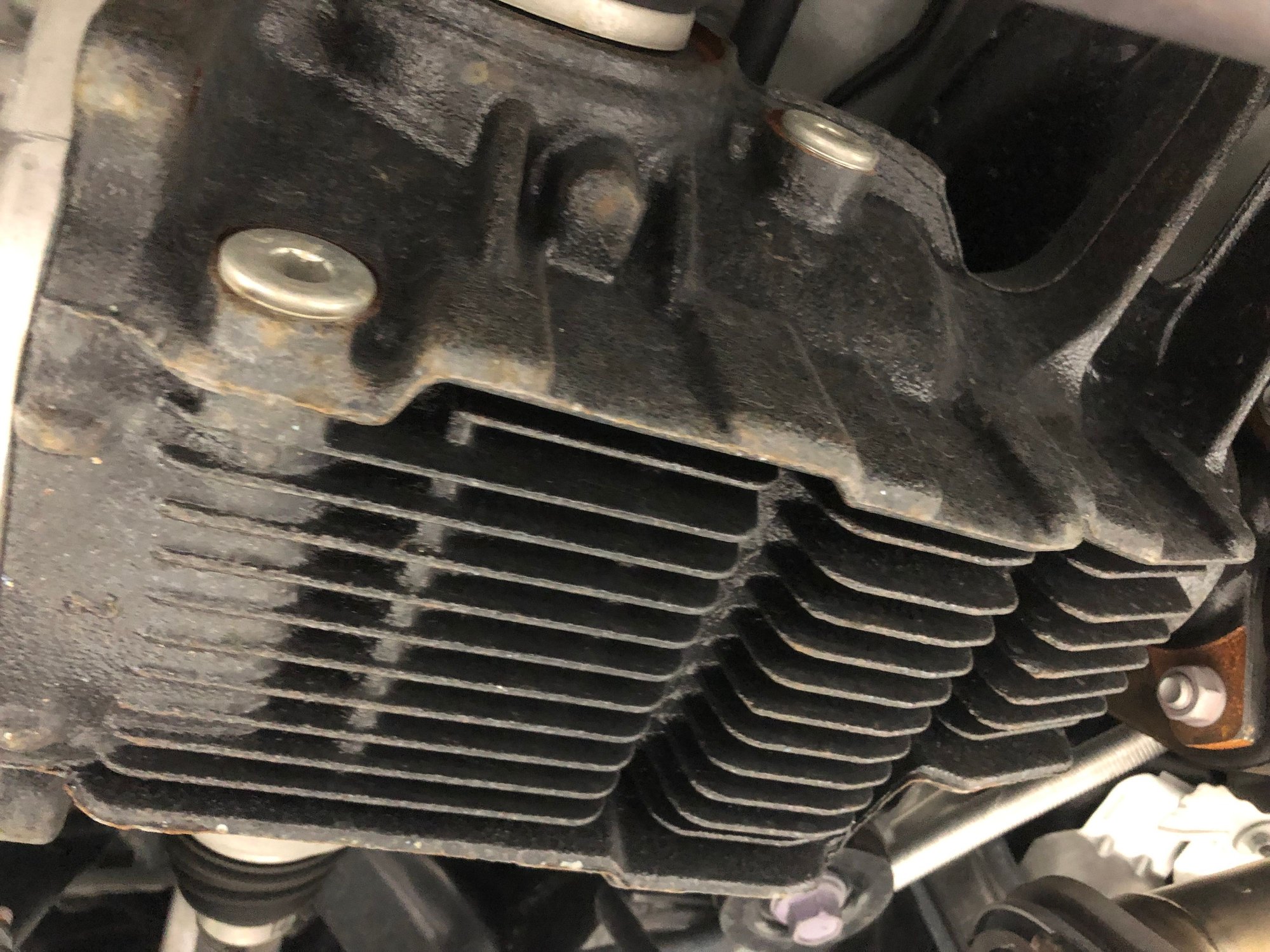

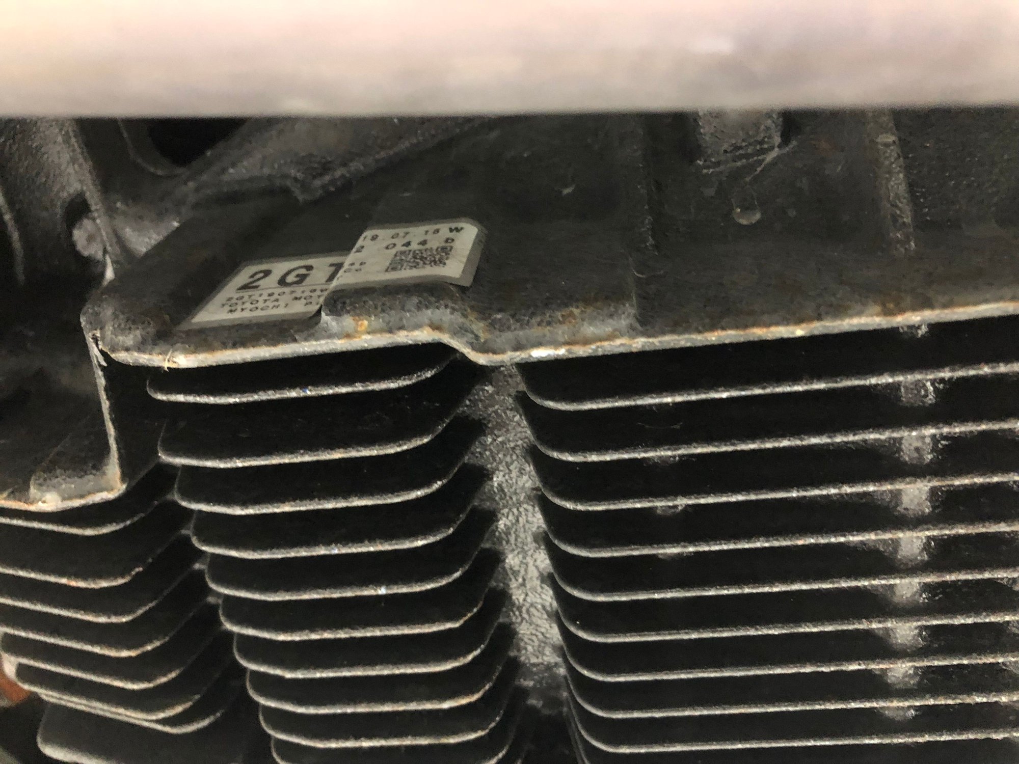

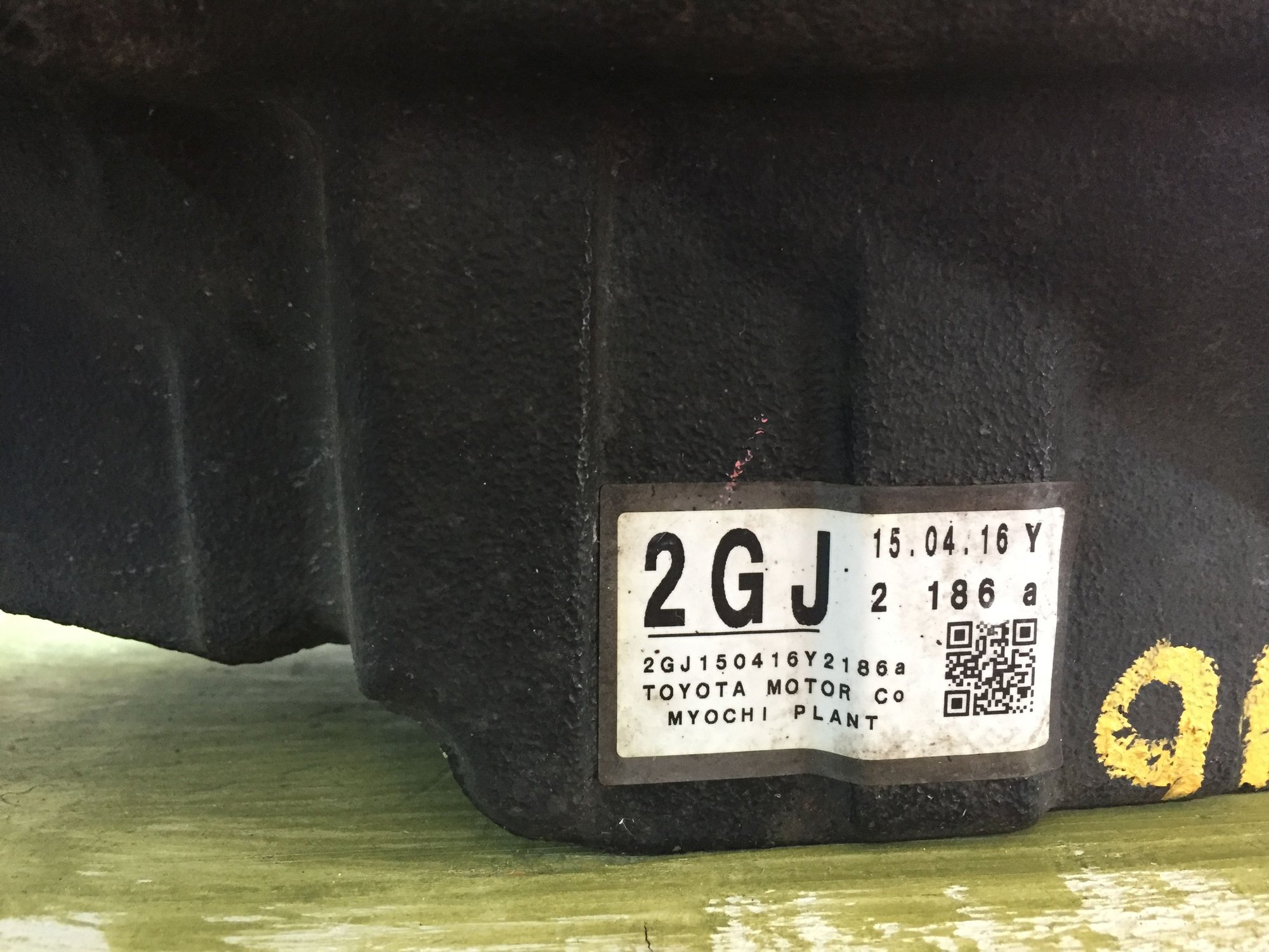

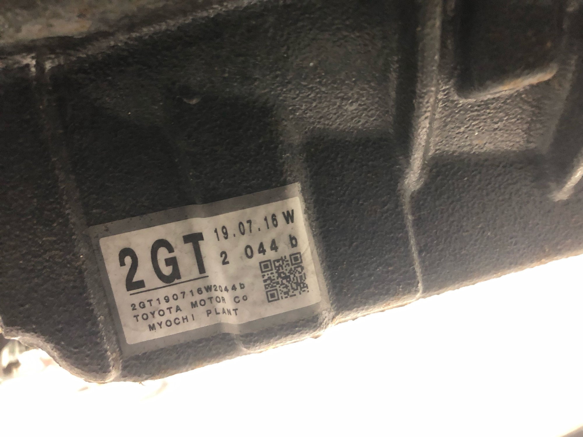

Looks like the 2020 Track Edition got a special tag with the Torsen LSD. Your rear was the first of the 3.133 new Gear Ratio on the differentials for MY20’+
My donor Torsen LSD unit came from a low mileage 2015 RC F - still using the same 2.937 found in 2015 to 2019.
The OEM TI exhaust axle sections look great (not flattened)..!! Did you add an aftermarket front TI section as well??

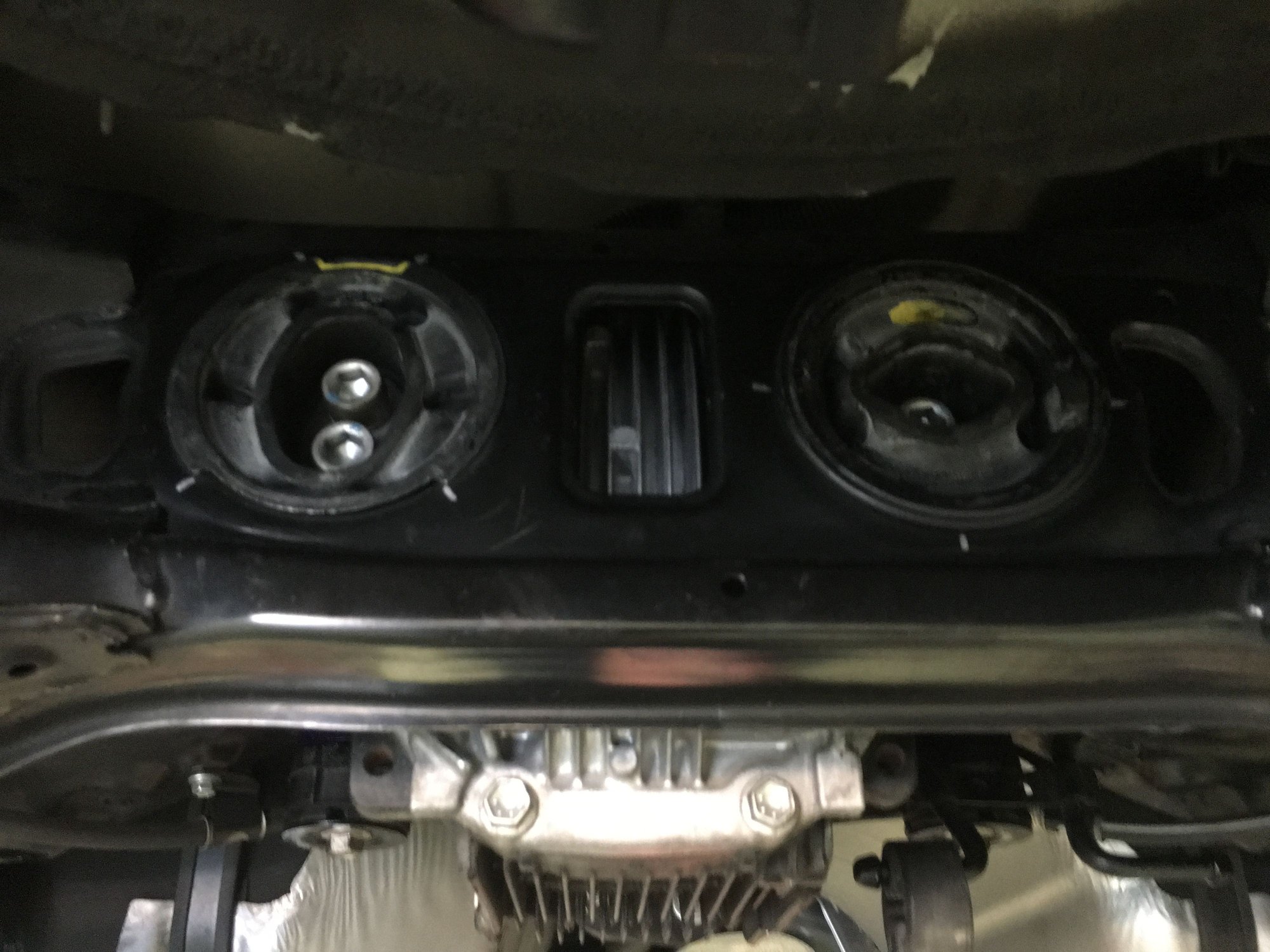

Updated to RC F differential mounts..

https://www.clublexus.com/forums/rc-...mid-pipes.html
yep! I ended up doing the novel headers cerakoted in black, and the gt haus ti mid pipe, looks like it's colored nicely!
I hope the pictures helped!!
