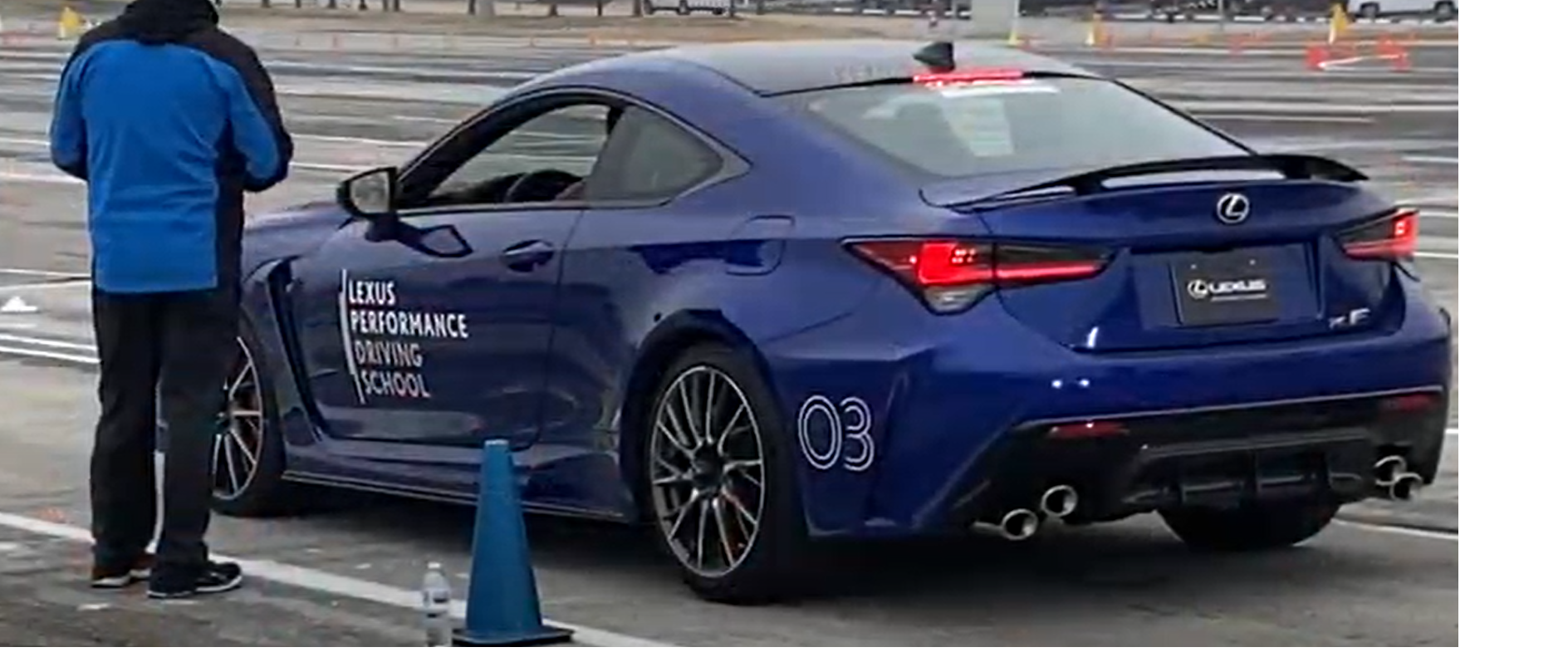

One thing I have wondered and seem to observe casually in photos posted on the Lexus Performance Driving School events it seems they only use Torsen equipped RCF's. If that is so I would imagine they do that to give better driver development, where they can help participants discern how their driving inputs impacts balance of the car. I could be wrong but be interesting for those who have participated to chime in
In Lexus driving school I have seen several videos of the carbon/TVD RCF on the slalom exercise. However,cost and availability is another thing to consider since the TVD is part of a more costly carbon option package and majority of the RCFs have LSD on them.
