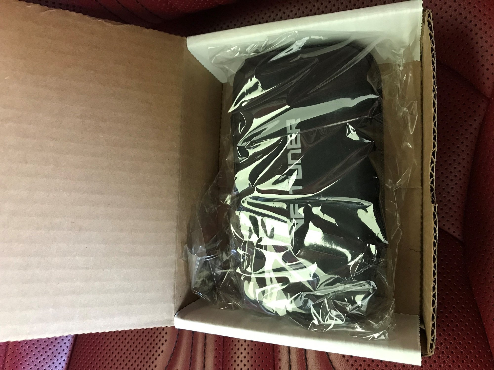

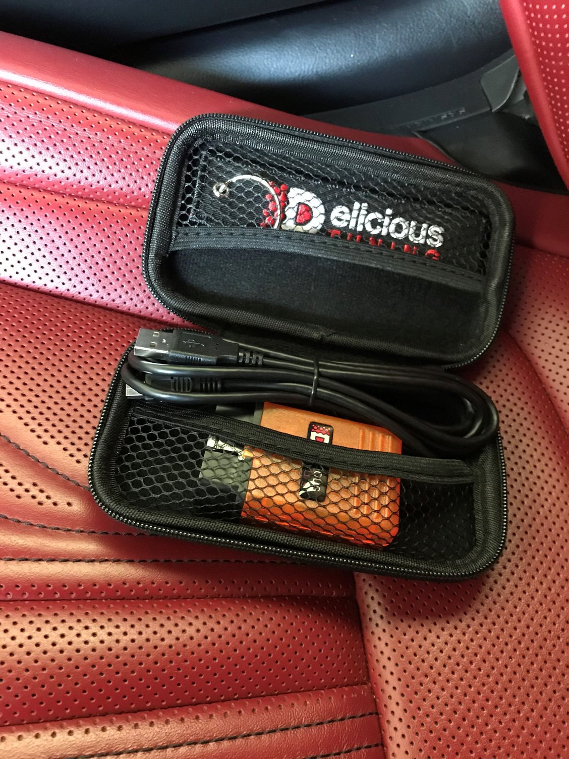

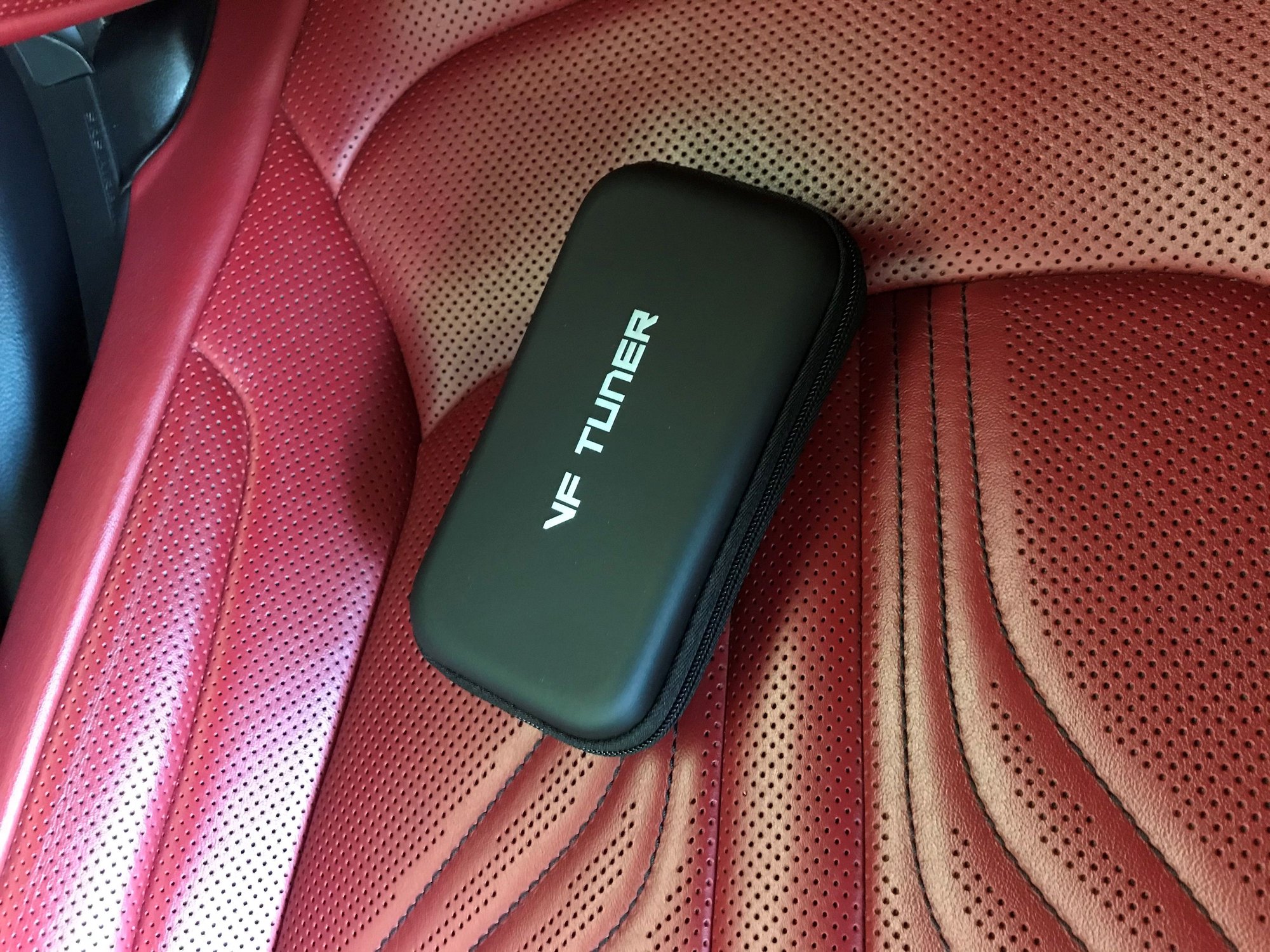

Just got my vftuner in the mail today too. I have a dyno tune schedule for the 17th. I look forward to seeing your numbers after the delicious tune!

Sweet! I'm going dyno mine on the 13th. Do you have headers installed on your car?

No headers yet. Just intake and exhaust. Im thinking about buying some this month through meraki. Would be awesome for us to get some real results to share on this forum between our two different setups though.

Your dyno guy is also going to dyno-tune your car?
I was just planning to run numbers but intend to ask my guy if he is able to dyno tune to further dial it in.

Thanks! Yup, my dyno guy will be doing the tuning. he has some experience with the software tuning Tundras, but i’ll save my stock lexus tune just in case. I think Delicious may have their tune locked so your guy may not be able to alter their tune. Hopefully thats not the case though and you can make all the powah!
