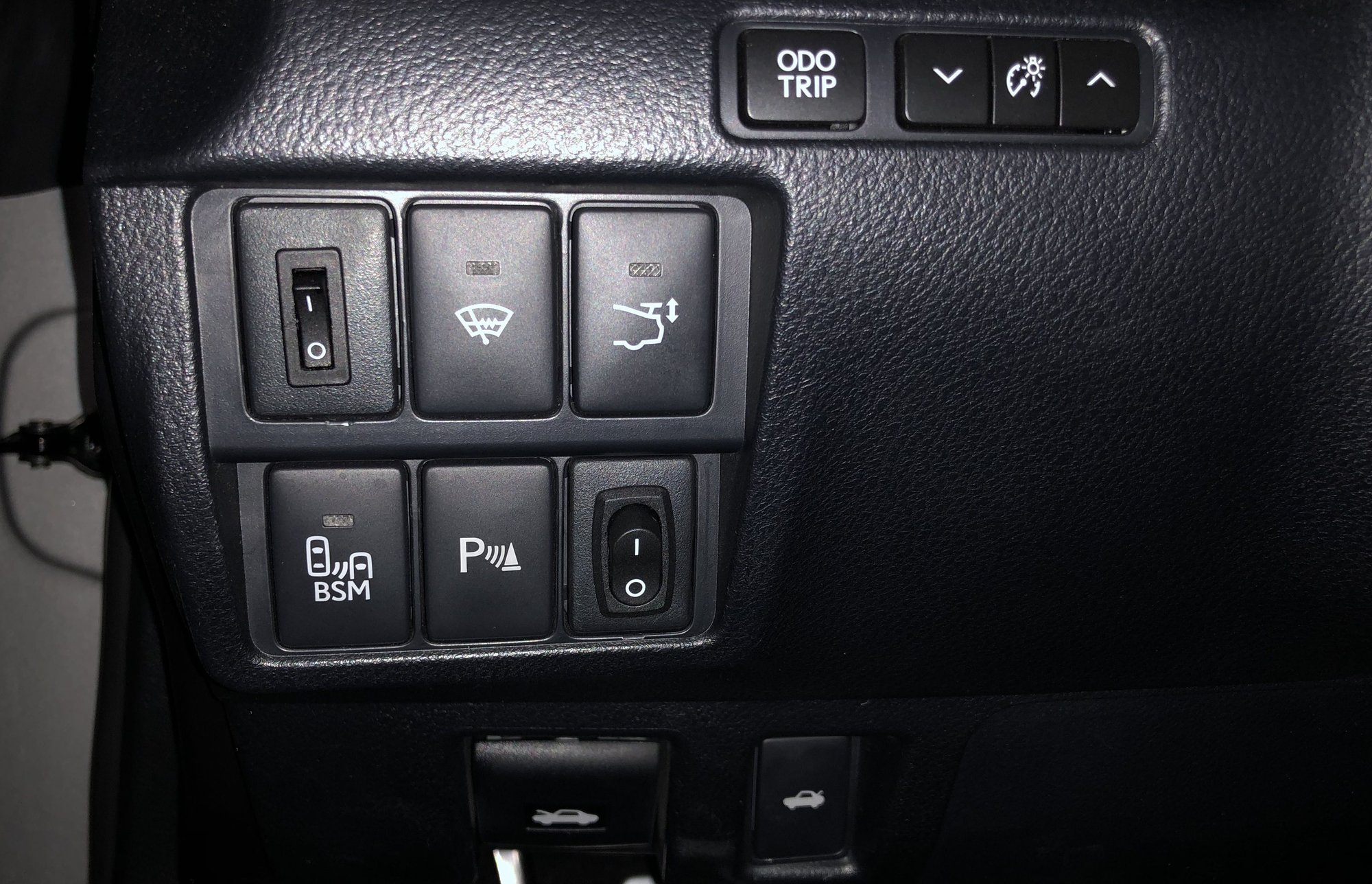

i have a couple of james bond switches. top left is for exhaust to open and close valves. remote or wired switch to control valves was a choice for ppe's system. i went with switch because it works faster and i really didn't want another fob.
bottom right is ejecto seato cuz. weird they look a little crooked. maybe angle i took the pic; need to investigate that.

Quote: i have a couple of james bond switches. top left is for exhaust to open and close valves. remote or wired switch to control valves was a choice for ppe's system. i went with switch because it works faster and i really didn't want another fob.
Nicely integrated to look stock
And good to know you can link it. Also don't want to be carrying another fob
