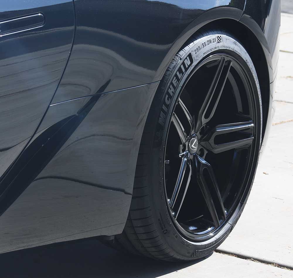

I'll upload a photo tomorrow. The valve stem on the cvt wheels is located not on the outside of the wheel but rather inside, half way between the outer lip and the inner lip. It protrudes outward and the valve is hitting the brake caliper. Link for reference

Spoke again with customer service at Vossen and they stated I would need outer mount adapters for the front. At $37 for the set, they're reasonably priced.
After looking at the valves myself, seems that only the valve stem cap made contact with the brake caliper, not the actual metal valve stem tip.
This is the condition of the front valve stems:
