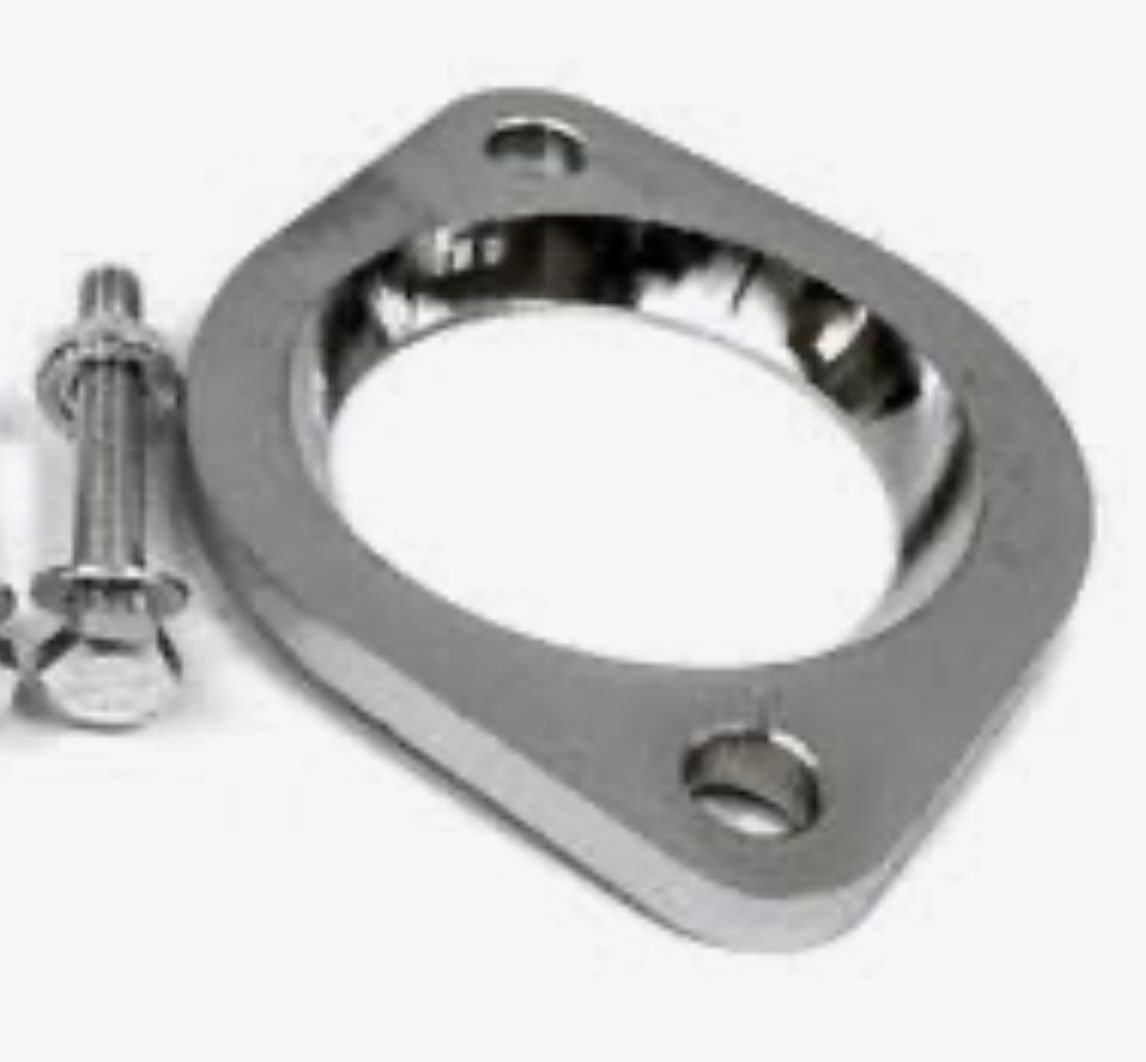

Try the exact opposite. Someone here made an adaptor from thin steel and welded it to the Invidia flange to step it down from 3” to 2.75”.
Old May 6, 2023 | 07:59 AM
jim2527's Avatar
jim2527
Joined: Dec 2017
Posts: 147
Likes: 53
Then there’s something like this:
