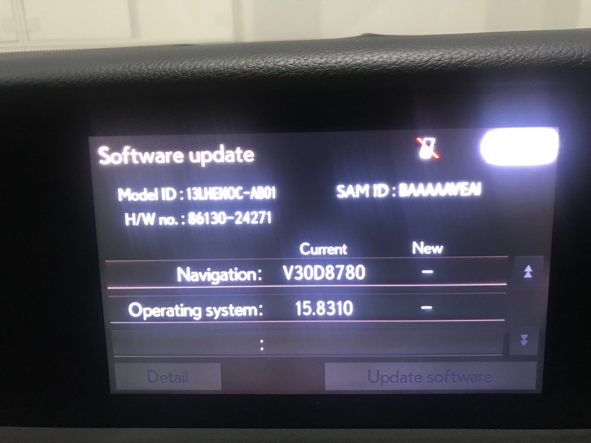

I need help, I downloaded the latest file available on USB and plugged into my RCF 2015. When trying to update the system the update software is indented and can’t be selected. Clearly my system is not the latest, please help.
Did you make sure there's no other file/files in the USB drive? Or try re-downloading and make sure the file name/format is right.
I'm guessing you don't have Navigation? This file is only for 2015-2017 RCF with navigation (the document attached to my post lists all models that it applies to). They system won't update unless the update applies to the system. Your hardware listed is 13LHENOC and the update file is for 13LHENNA hardware. Or maybe you're not in North America (wild guess)? Not sure how to help you here, the Lexus website only seems to have updates for cars less than 3 years old.

I will try to isolate the file on the USB because when I tried I had other files on the USB. The file name is correct. I am in Australia so yes maybe might not be compatible. I will have a good and let you know. Thanks

So I tried isolating file on USB. The system can recognize there is a file but system flagged the file available is not compatible. I am in Australia so I think our models are same as JDM.
Can anyone help?
