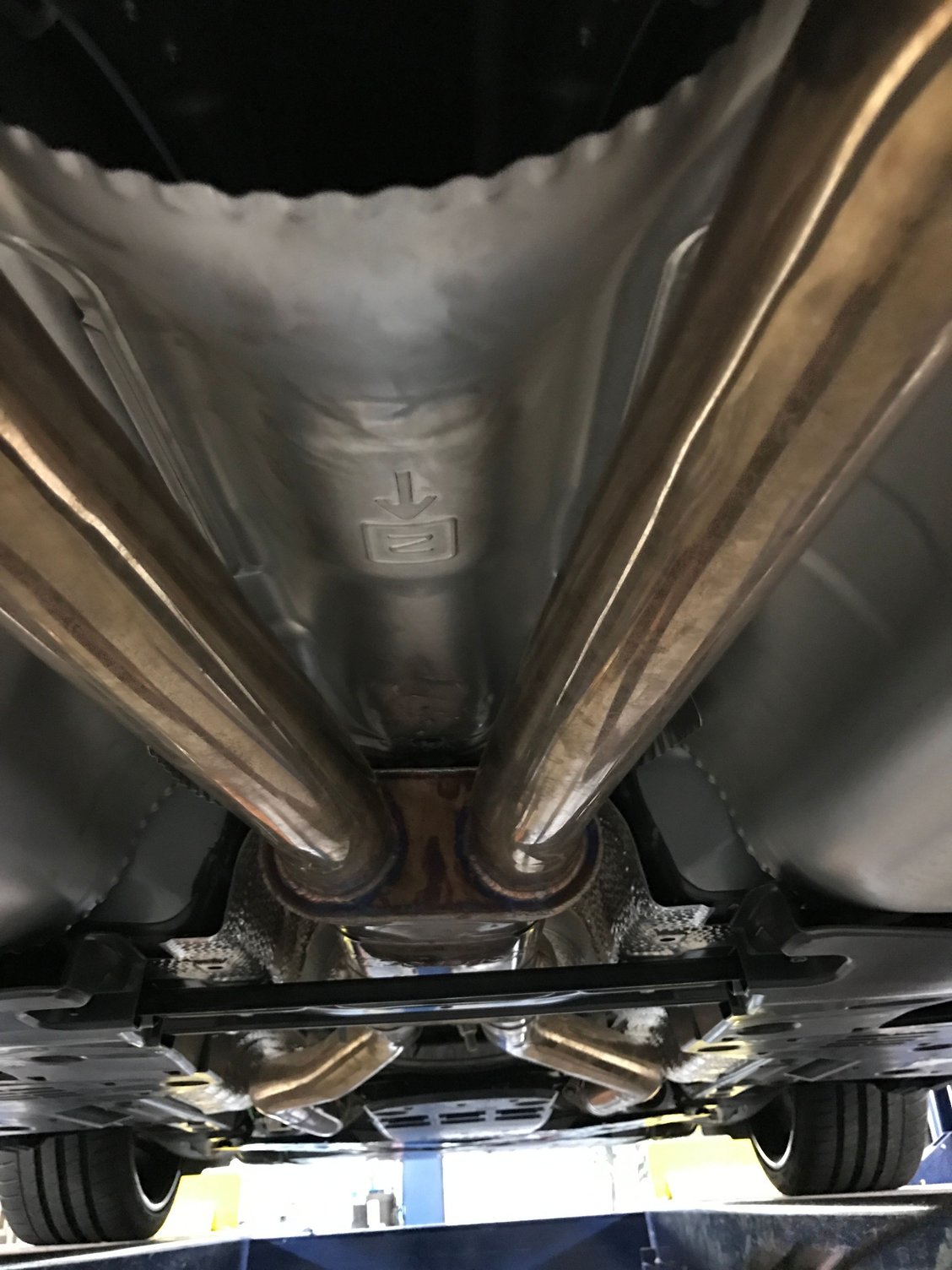

Alright guys I installed the gthaus exhaust system a couple days ago. I was getting a rattle on start up and during low rpm driving, put the car up on the lift and it looks like the heat shield is resting on the resonated x pipe section.
did any of you guys have to remove the heat shield or cut it to prevent it from rattling, or making contact with the resonator?
thanks.

I don't get any rattles at all with mine. I shaped and bent that shield to make sure there's proper clearance between it and the pipes. It is really soft and easy to do, I didn't cut or trim it at all.
thanks.

I figured out the rattle noise, a part inside the resonator actually broke off and was rattling inside. The whole midsection was cracked all over as well, thankfully I got it fixed by my friend who owns a fabrication shop.
