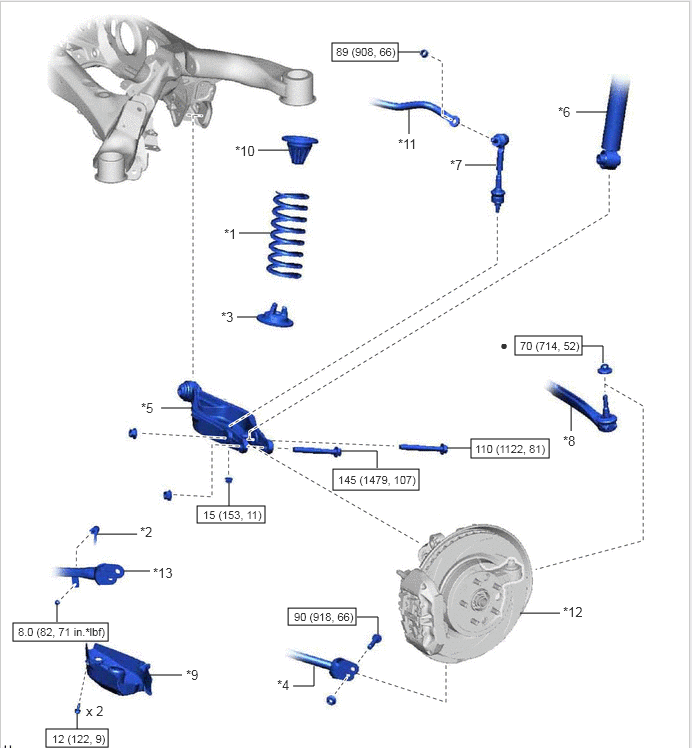

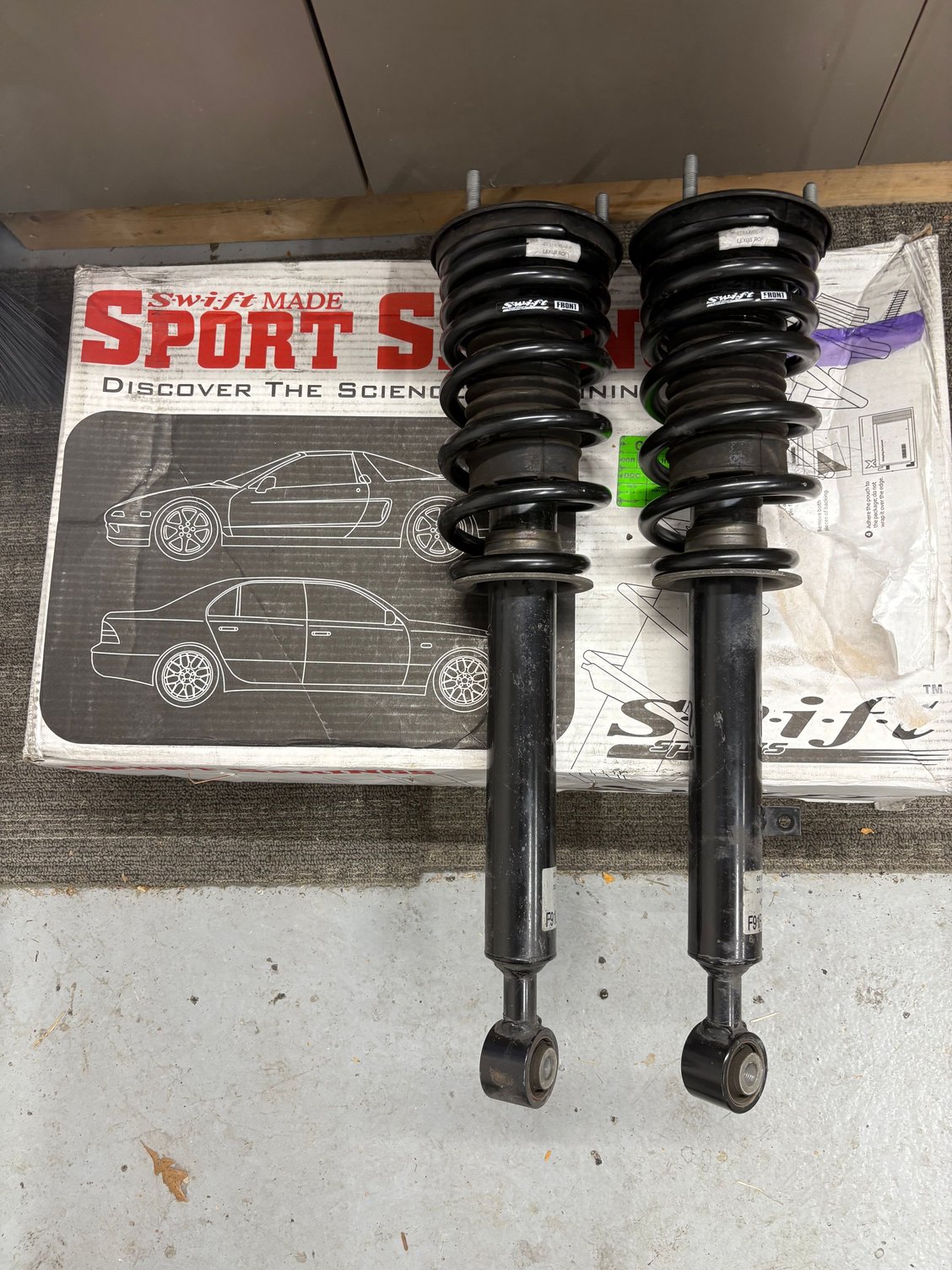

Good evening guys, I am in the process of installing some swift lowering springs on my RCF and after reassembling the front went looking for torque specs. I have searched high and low but am having zero luck finding anything online.
Does anyone have the FSM and could share one of those exploded style photos with the torque specs for the front and rear?

Here you go.
