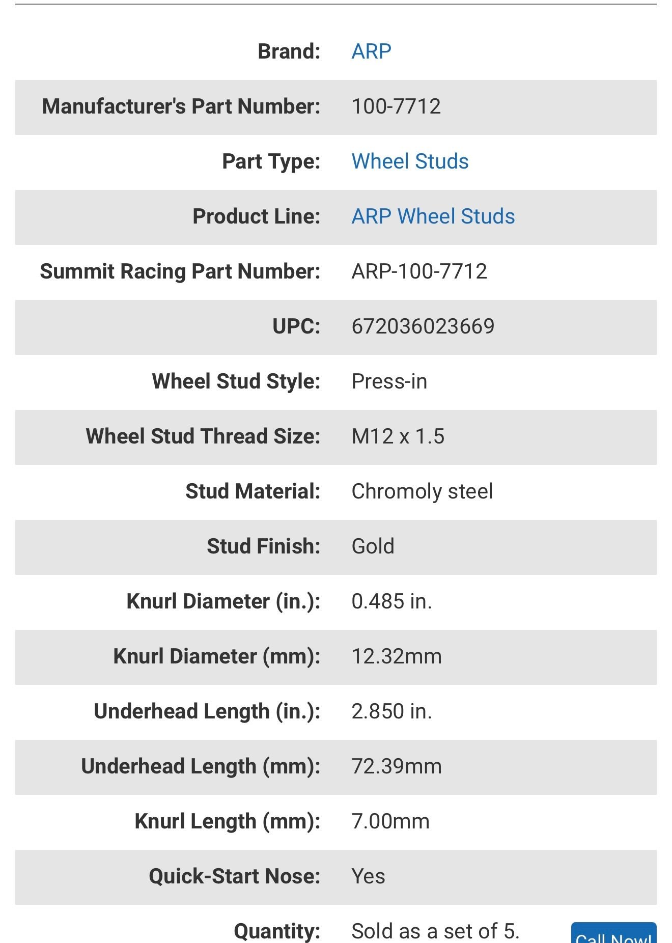

How exactly are the rears not fitting? The knurled part too big in diameter? Or the stud is too long to get it inserted from behind. I know with ARP studs, the rears need to be trimmed a little or the hubs need to be removed. I have ARP (IS300) studs on both my RC F and IS F.
Edit: like @LoSt180 said, you may have aftermarket rear hubs, the knurl diameter of the arp stud
or OEM stud is too big for your rear hub flange. So like he said, you can drill the holes to proper diameter or find studs with the correct knurl diameter. Looked through summit racing list of arp studs with 12x1.5 thread and found some with knurl diameter of 12.3. OEM is 14.xxmm IIRC.
