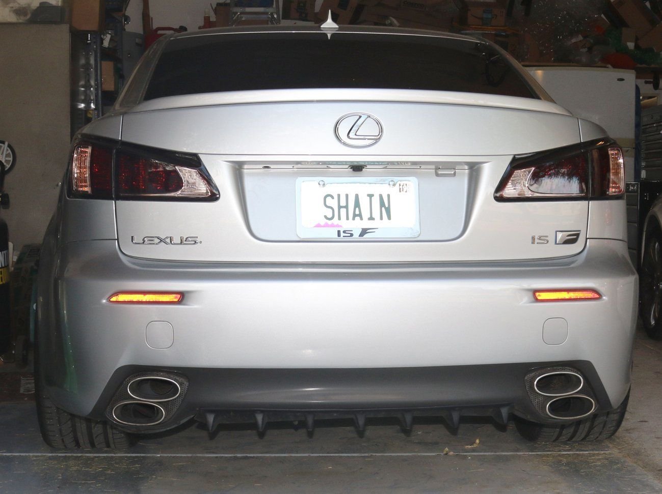

Ran 255/35/19 and 295/35/19 and had no issues, actually had more grip than stock (reason why I went wider).
What exhaust is that? Looks nasty!
Did you notice any issues with the speedo being inaccurate with the slightly larger diameter tires?
