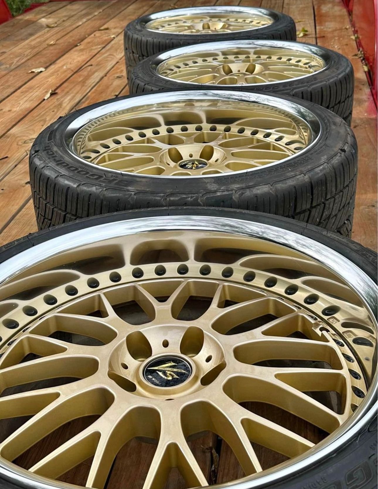

Just got an RC-F a few months ago and trying to figure out if these wheel specs will fit. Any help would be appreciated. If anyone has similar specs, some pictures would be nice.
Fronts-19×9.5 +17 Tire size 245/35/19
Rears-19x10.5 +17 Tire size 275/35/19
5×114.3

Too aggressive, they'll poke out the sides. There's a few wheel threads, try looking through those. Basically you want offsets in the 30s for these cars.

Agreed. Offsets are too wide. The wheels are slightly wider, but would be an issue, if the offsets were that aggressive.
