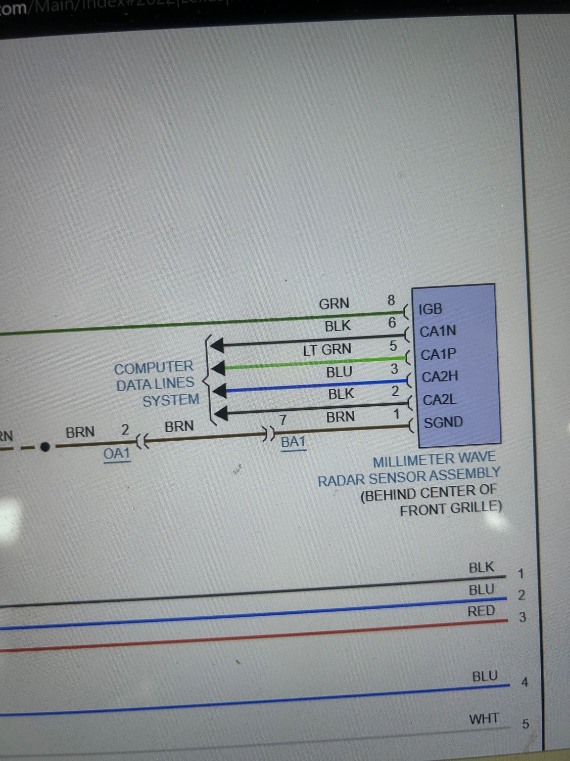

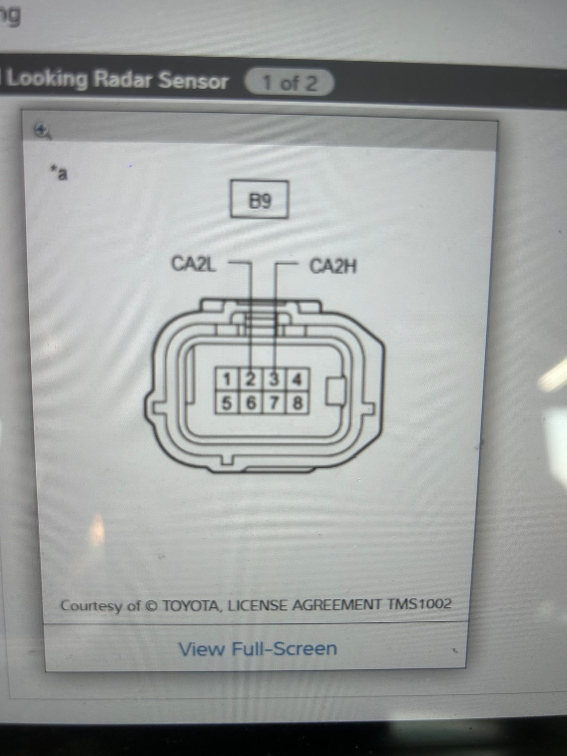

I have broken wires to the disctronic connector. I don't know how to connect it correctly. Lexus RC 300 F 2022

I believe this is the correct one
