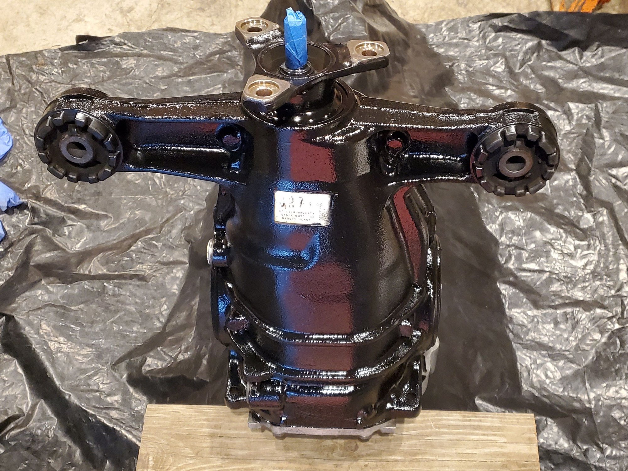

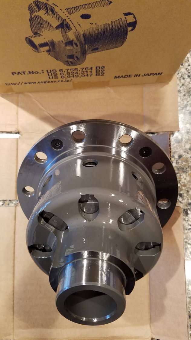

They do not interchange. Whole different pumpkin! That said, IS250C is the same as 350. But this doesn't help you one bit.
Pictures are of IS350 diff and OS Giken LSD TCD.
Your options are ^^ or buying a RC-F or IS-F Torsen LSD and installing the Torsen unit in your case as they have 2.937:1 ratios vs our 4.08:1/4.10:1 350's...
It's not going to work cause the 4.10 rear diff needs to match the 4.10 in the front or else it'll mess up my awd system. Plus the awd uses a totally different drivetrain from the RWDs. 250 rwd, 350 rwd and awd 250/350 each has their their own.
