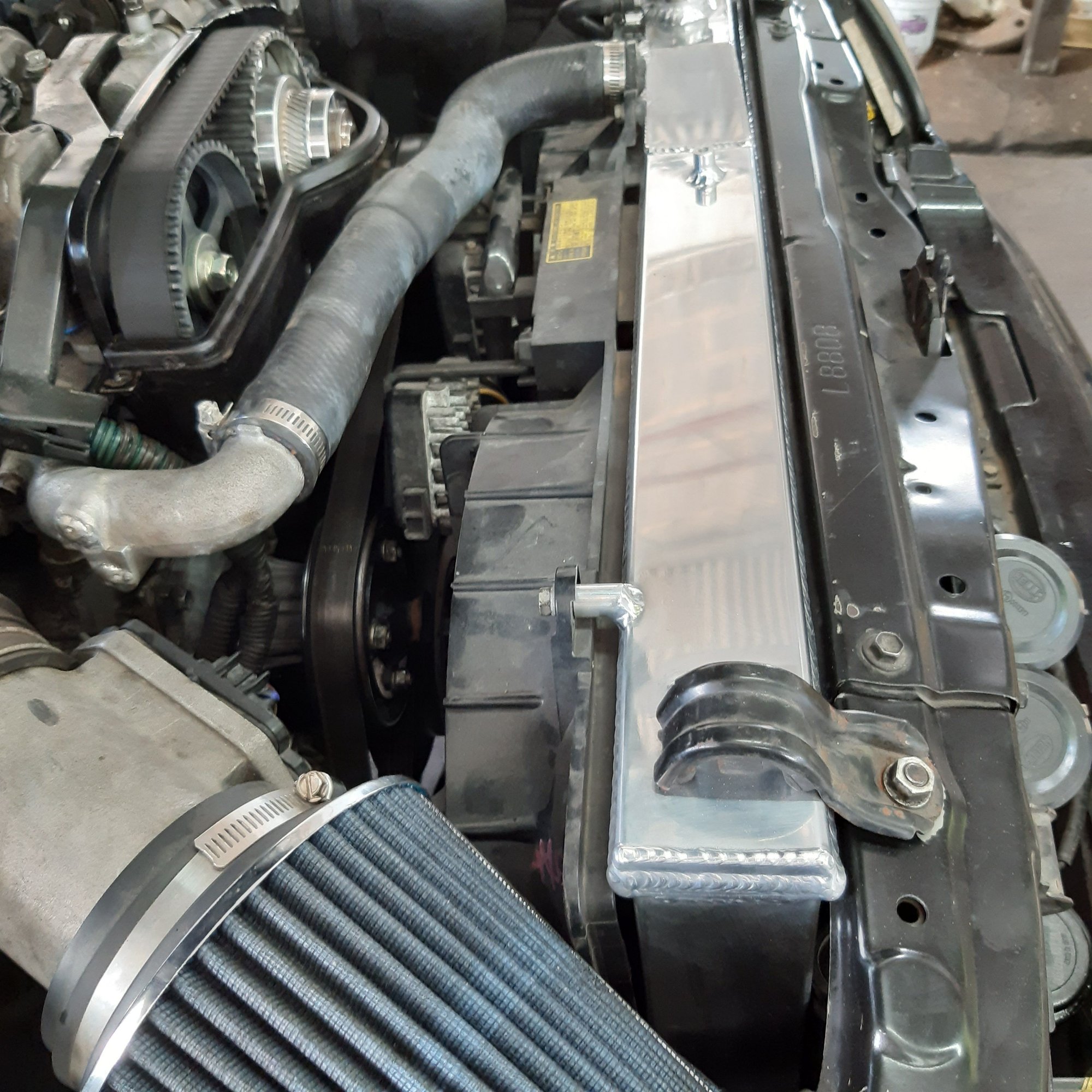

Ebay 210. Aristo. Seperate transcooler.
Got it with bends all four tanks.
My guy straightened them out.
Toyota coolant.
Caribbean tropical climate so say 20-36C in general.
Have yet to dtive it. Fit Aristo like a glove after straightening. Fans hoses plugs. The clamps dont look right but they do the job.
