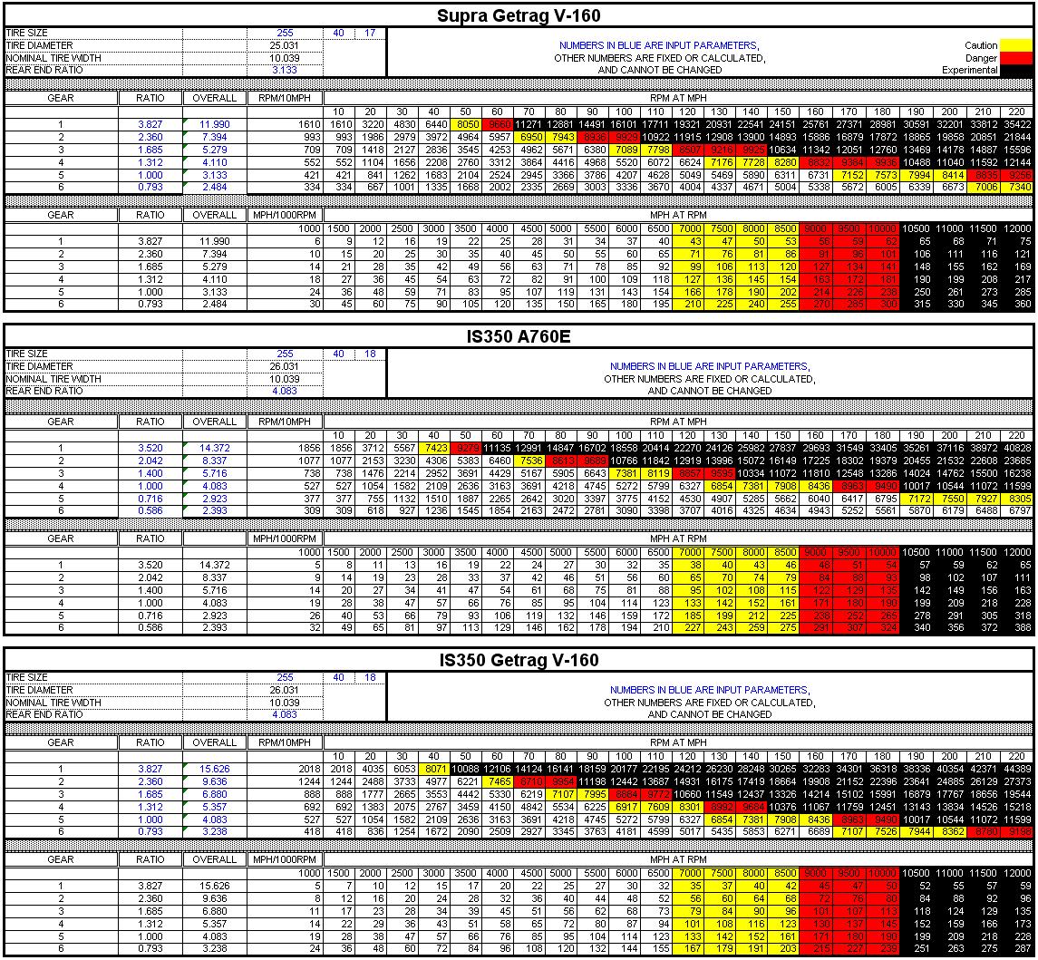

You need to consider the entire system. Transmission gears, final drive gears, and tire size. I have a spreadsheet I use for this. It looks like this:
Of course mine allows you to adjust tire sizes and final drive ratios. You can also (on another sheet) put in the torque and figure out the thrust at the tire/road interface which is what you really need to know anyway. And, this is the most important thing to understand when comparing cars with different drivetrains - the peak torque figure means almost nothing at all when comparing disparate platforms.
