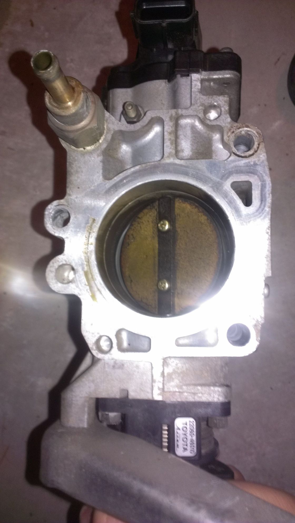

Hey guys i have the same problem, being in limp mode blah blah blah. tomorrow im gonna buy a new tb for 100 and hope it will fix my problem but i was wondering is this how the butterfly suppose to open when its full throttle? thats me holding the level assembly all the way open and its like 10% open at full throttle could it be the lever or try to replace the motor first?
Yeah, the throttle is electronically controlled by the motor on the opposite side. When in limp mode the cable will allow you to only open it that much to "limp" somewhere. I was get up to 40MPG and drove to a shop 4-5 miles away.
I replaced the TPS and was still throwing a code so I replaced this "LEVER ASSEMBLY, THROTTLE W/SENSOR" part. It was still throwing a code so I clear the code, unplugged all the sensors, plugged them back in and it fixed the problem. 3 weeks and 1000 miles so far, no problems.
The plug was brittle and crumbled to pieces, so now I need a new plug. Anybody have a lead on it?
2206046010
http://lexus.sewellparts.com/oem-cat...S300-1999.html
