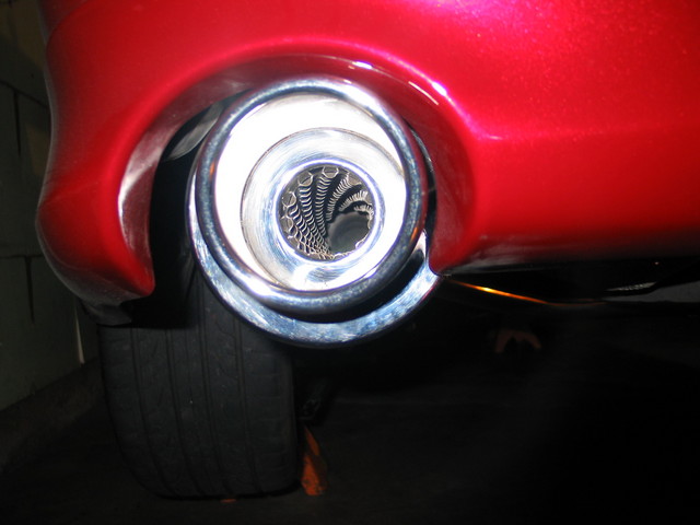

After a slight delay in the delivery, the exhaust has finally been installed. It’s a stainless steel, true dual, CATBACK exhaust system with H-pipe, polished stainless at the rear section only. It is not smog legal due to the removal of the 2 rear catalytic converters. The front cats are still retained. The exhaust comes with two resonators.

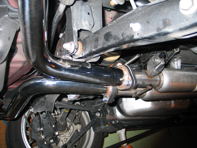

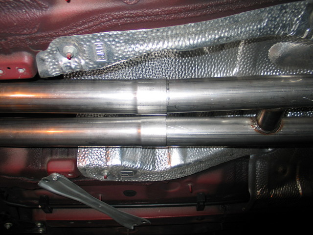

Although this is marketed as a simple bolt on, installation is not as easy as you would hope. The fit was very tight, and has to be maneuvered EXACTLY into place. The front/H-pipe just bolts up to the front cats. The only tricky part about the H-pipe is removing the oxygen sensors. You will need to unbolt the stock front Y pipe from the cats and lower it far enough to use an oxygen sensor socket with a slit on the side to accommodate the wire for the sensor. You will not be able to use an open end or box wrench on the oxygen sensor due to the shielding around it. The mid pipe with resonators have to be slipped onto the front H-pipe and hammered into place. Be careful not to damage the flange.
The exhaust hangers on the mid pipe are designed to have one pulling up and one pulling down. This will hopefully eliminate the excessive movement the stock exhaust had. We were told by LMS that the supplied exhaust clamps are optional. It would also make removal of the mid pipe easier if/when you needed to put the stock exhaust back on. At this point installation gets trickier. You will need an assistant to help manipulate the rear sections to the proper location while you tighten the fasteners at the flange. This might take a couple of tries to get it just right.

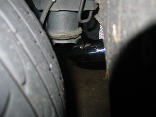

Another little issue with my car is that the left tailpipe is not completely center, possibly due to the fact that I have the factory body/ground effects kit on there. The original test car did not have the body kit.
One last thing, the piping for the left rear section will come close or come in contact with the big washer for the bolt on the sub frame. You will need to loosen the bolt and turn the washer so the tang on the big washer clears the piping.

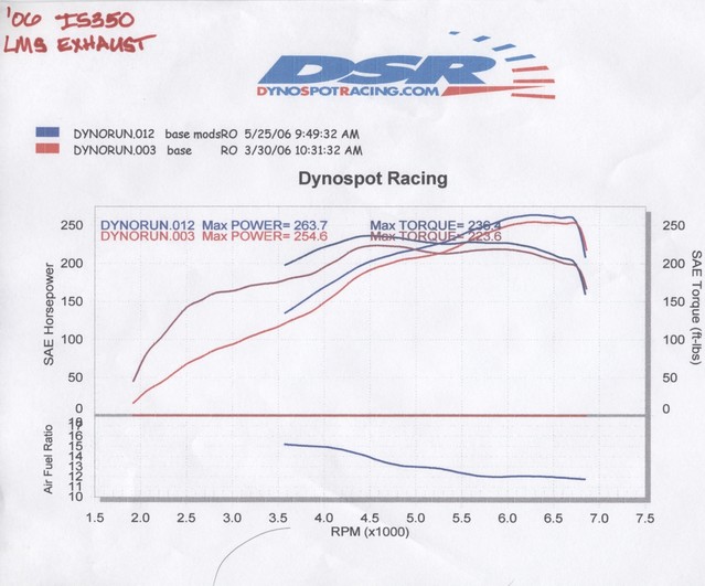

A baseline dyno was already impressive with horsepower readings of 254.6 (to the wheels) and torque of 223.6. Readings after the exhaust showed maximum horsepower of 263.7 and torque of 236.4. There were reported gains of 22 rwhp. This however was reported with a prototype. I know for a fact the resonators had to be redone (due to the fact that they were too loud), and I haven’t seen any other dyno sheets with the production model. Depending on many variables (different dyno machines, temperature/humidity, etc.), the results will vary.
