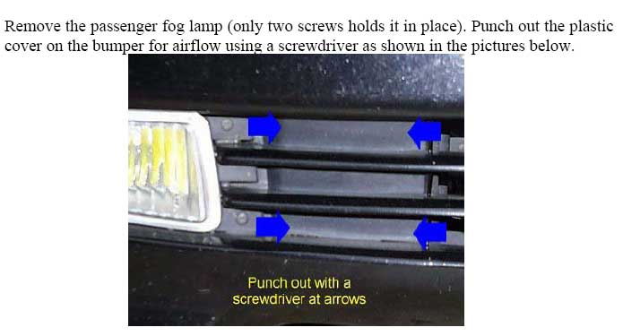

how do I remove that little plastic piece thats next to the passenger fog light???? I did a search but there are way to many threads on "SRT"

Sweet.....thanks

sweet Im going to do this

I think all CAI can benefit from this.
