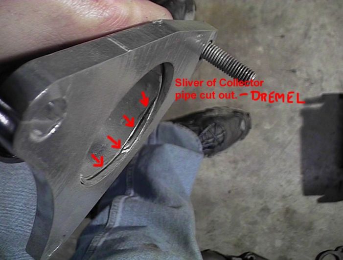

Old Nov 28, 2005 | 09:14 PM
BA_GS400's Avatar
BA_GS400
Joined: May 2004
Posts: 806
Default Modified Header to Catalytic no gasket
Attached Thumbnails BA's Header Installation Steps-11-gs400-modified-header-to-catalytic-no-gasket.jpg

Wow, excellent write up, excellent detail on the fitment concern. I didn't have cats to send to S&S and therefore the cat protrusion was not known. I will contact S&S immediately and get this addressed. Apologies to everyone that has this problem. Giant thanks to Allan for this contribution.
