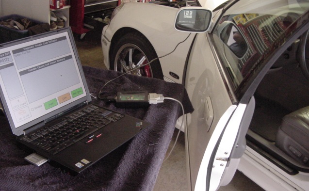

Default tuning
Started the tuning process. Once close I will take it in the dyno shop for final tuning and testing.
First pic shows the system set of an error code as it was running a bit rich
Old Oct 18, 2004 | 08:32 PM
  #70
Pearlpower's Avatar
Pearlpower
CL Folding 25,000
Joined: Apr 2002
Posts: 7,075
Likes: 19
Default setup pic
Setup. Connected to USB port via serial adapter and to OBDII connection on car.
