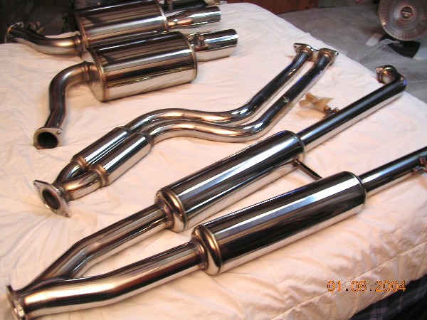

I'm defintaly going to need your help in tuning sometime this summer. As soon as i get my hands on a s-afcII. I would like to redyno my car after i get another piece of exhaust from carton toyota. I already have the cat back exhaust. I'm just waiting for the midpipe.
