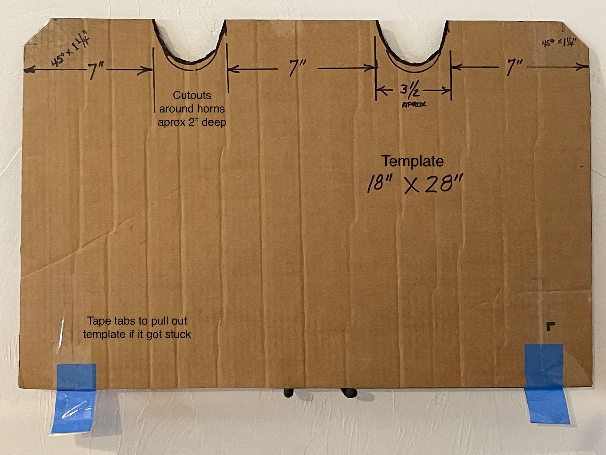

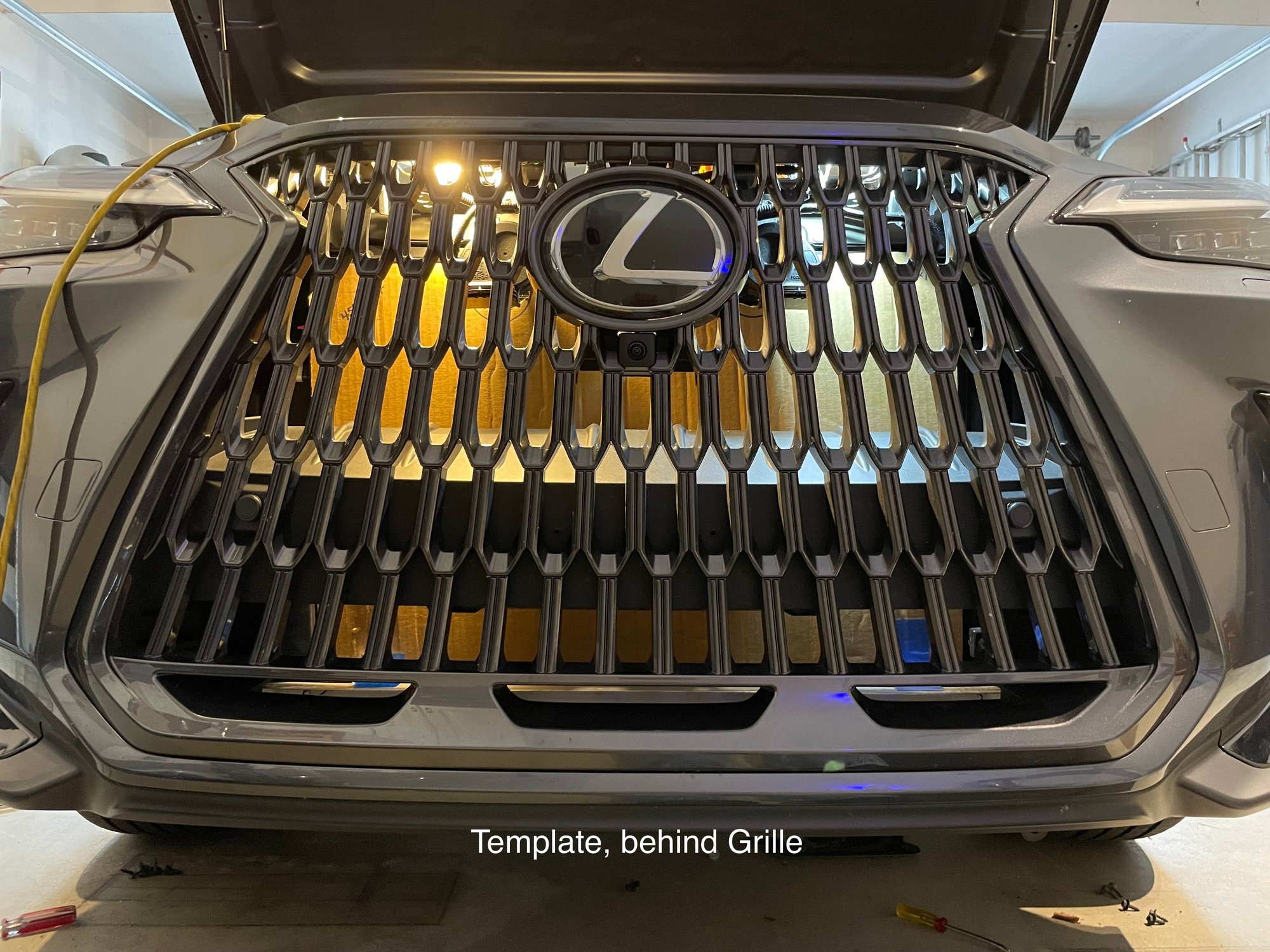

Today I worked on making a template to protect the condenser and radiator (C&R) from stone damage that may get through the grille openings.
I removed the top cover over the C&R, front-under the hood, (9 pushpins). Then: removed the front-bottom cover under the C&R. (a bunch of 10mm hex screws)
Next: removed the 2nd cover behind bottom cover. (push-in fittings)
Made template 18” high x 28” wide, which covers almost 100% of the Condenser.
The template slips up from under the front of the NX between the square aluminum and curved aluminum bumper brace. (photo)
It took me quite a few hours to disassemble, cut & fit a template and replace the three covers. I only have one pushpin left over.
But I am pleased that I could even make & fit a template.

My wife’s Tucson grille openings are 1 1/4” x 2 1/4” - My neighbors Lexus LX600 openings are 1” x 4”
Our NX grille openings are really in the ballpark of these others: Our upper rows are 3/4” x 3” , the bottom row of 18 openings are 1 1/4” x 2”
