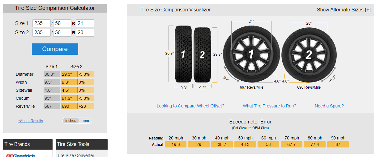

why not use 235 - 45 - 21's? they would provide equal outside diameter and no speedometer error issues
Here's a calculator tool:
https://tiresize.com/calculator/

We’re on the same page, I just want to confirm that the wheels will mount and fit correctly.
