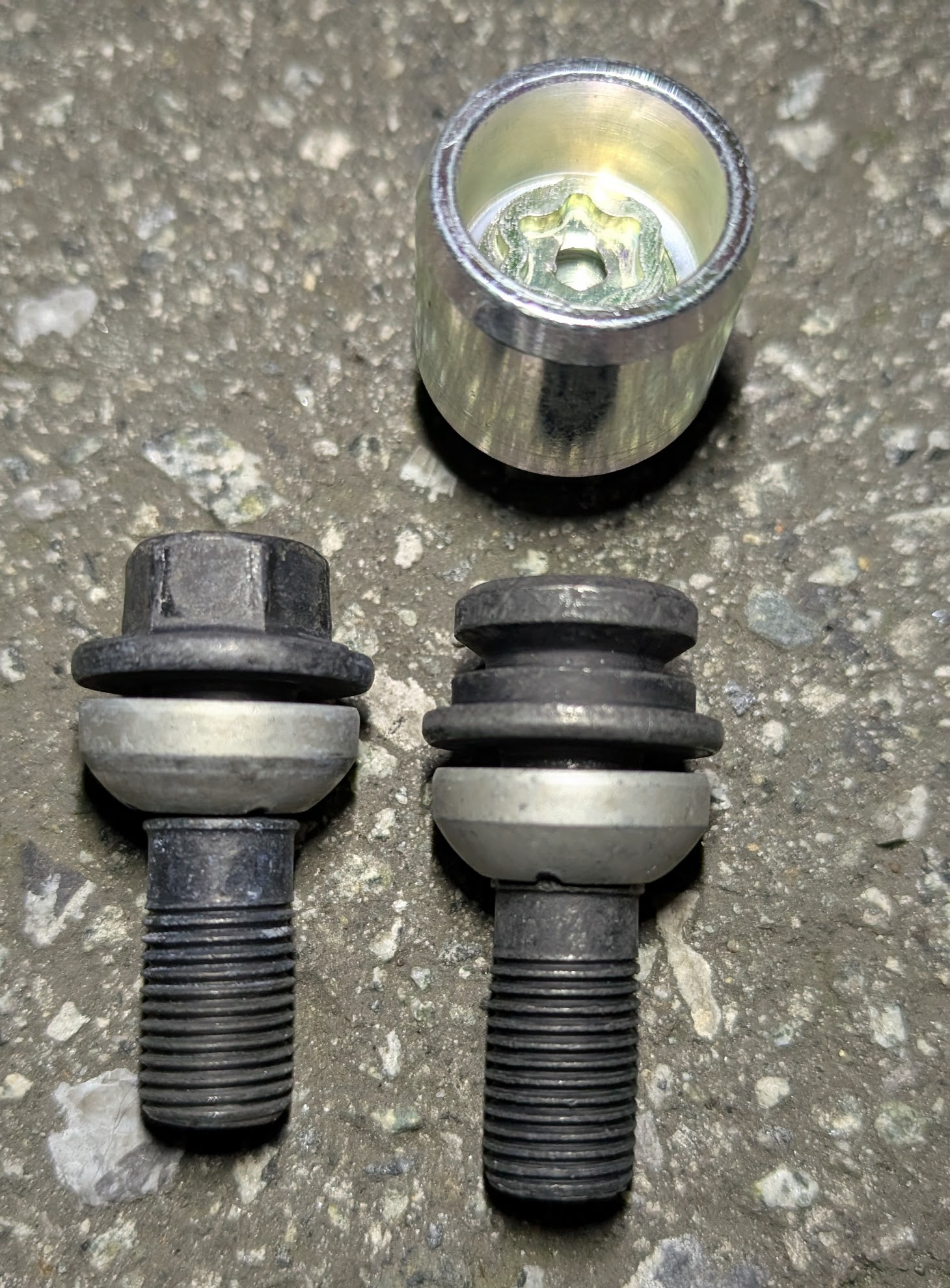

I finally got my dealer to confirm which locking lug bolts are appropriate for the '25 NX. It is the same as '24 (different than '23 and prior).
PT276-48230-02
https://parts.lexus.com/p/Lexus__/Wh...764823002.html
See comparison below. Assembled without issue. Made by McGard.

Why does your set with the same labeled part number have bolts? The linked set does not.
Lexus parts website always shows generic stock photos, not model specific. The link is correct, per my photo. Feel free to call a dealer if you're concerned.
Unfortunately, that’s untrue. The locks my dealer showed me for that model number were exactly what is online. That’s why it’s confusing that what you purchased doesn’t have a separate model number.
