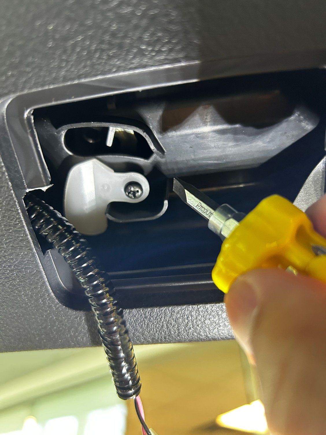

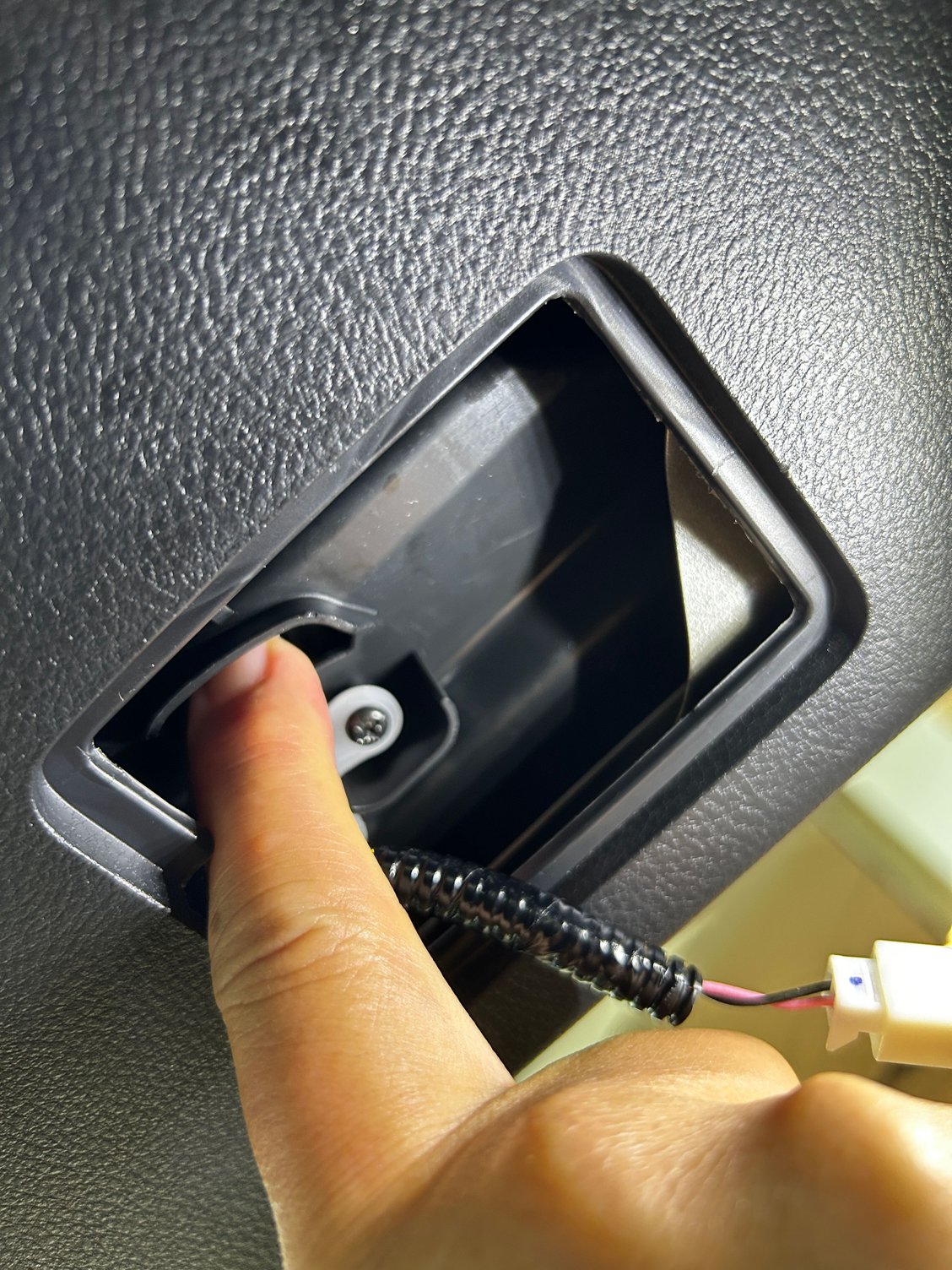

Default Manually Open the Rear Hatch 2022 to 2026 NX, NX350h or NX450h
Use a flat head screw driver to pop open the plastic cover (with LED). You will see a L-shape White Plastic. If you can't turn the L-Shape Plastic anti-clockwise, loosen the screw that is screwed on to the plastic. Once it is moved, you will see a metal level. Push it to the right and it will release the hatch.

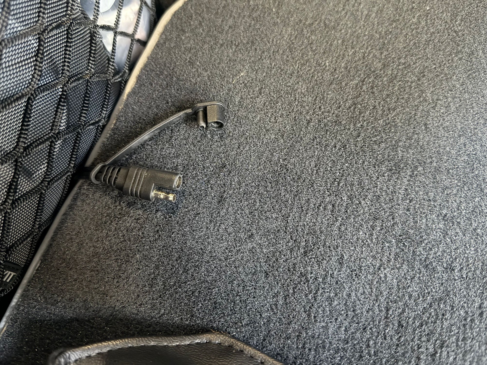

Originally Posted by gamma742
I did drill a small hole through the plastic.
you wouldn’t happen to have a tutorial would you? Like how did you snake the cable through to the port?

No is was a simple mod
I’m interested in doing the same so thanks in advance for your help. I’m a noob so have a lot of questions.
Where did you know to drill the hole?
How did you snake the wire there? Did you do it under all the panelling in the trunk? I was looking and wasn’t sure how I’d get it to the charging panel.
How does the door close without the trickle charger outlet getting in the way?
would you have a few more images showing what it looks like? No worries if you don’t.
Thank You!!! I was wondering if there was a manual override!
I have a quick disconnect that is connected to the 12V Battery that runs up and out by the First Aid storage pocket which connects to my Trickler that I run through the back hatch or if I need to boost it from my portable booster.

Default Can't move the latch all the way to unlock trunk
First time completely dead 12V (2024 NX450h+). Accessed from inside, removed the center panel as shown above, counter clockwise rotated the plastic cover and exposed the latch. I can move the latch maybe a quarter inch to the right with finger, but it hit something and won't move further. The trunk is still locked. Any insight? Thank you

Thank you. It is in my garage head in, was trying to get a neighbor to jump start but the cable is not long enough for the front hood. I managed to open the battery cover in the trunk so the cable goes in from driver side rear door, just long enough to hook up and jump. Now I am sitting at Lexus dealership for an emergency appt. When I called Lexus, they mentioned they could tow it and tow is covered because the battery is under warranty. I still don't understand why I couldn't move the latch if it's designed for dead battery situation.
