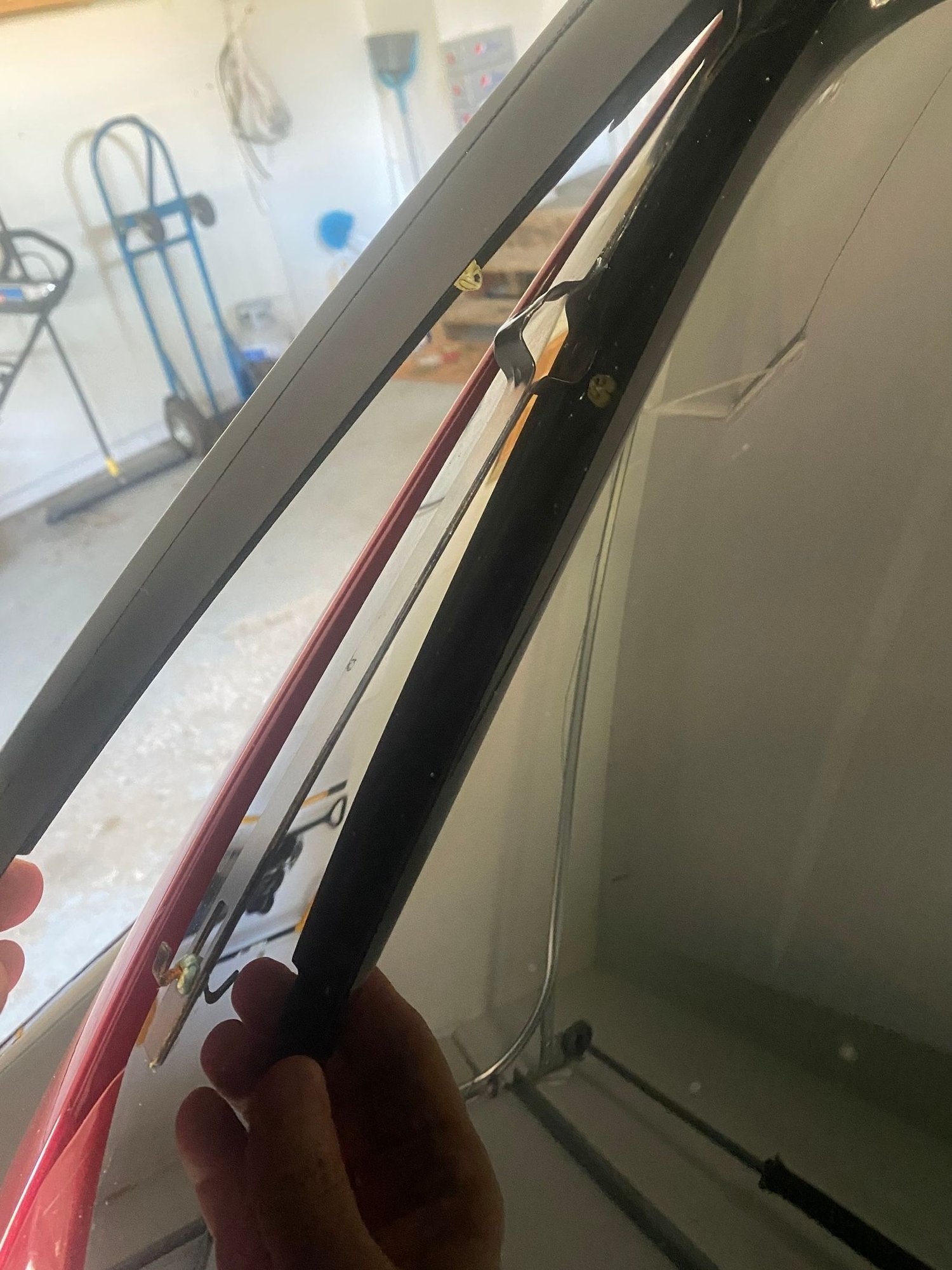

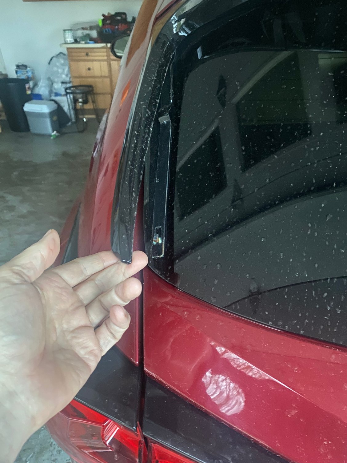

Does anyone know how to fix the hatch trim properly? I recently bought the car used and I found it’s not installed correctly.

It is actually *2 in the diagram. The part in the blue eclipse is a metal hook that is supposed to hook into the plastic so I think I may have to remove *7 to properly get the side piece hooked in. I’ve added another photo for clarity.

The new photo is much more descriptive and clear. Item *2 is actually an antenna amplifier.
I agree with your conclusion that the 3-piece rear spoiler (Item *7) must be partially removed first.
If you look closely at the upper left corner, you should see (and feel) the seam between the left and center pieces. Unfortunately, to remove and re-fasten the left piece, the large top (center) piece must be removed first (though perhaps only partially)
In attached Image 1, is bracket "A" still fastened securely to the glass? I will assume "yes" for now.
The large center part of the spoiler is unfastened from inside with the hatch open. Refer to Images 2 and 3 for details.
Once that part is removed, the left piece can then be removed and re-fastened (bottom retainer first, as you surmised). Refer to Image 4.
The purpose of the tape is to prevent paint damage when using a nylon molding removal tool to release the clips.
