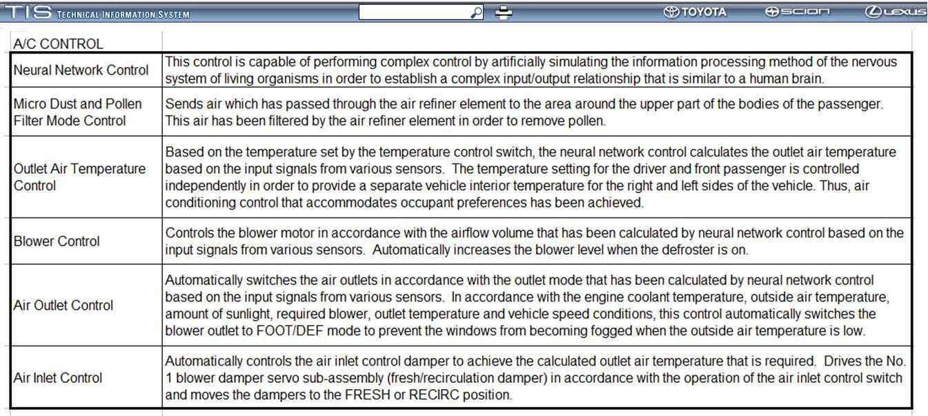

Do the last 3 sections in this table match your observations?
That control mode should only be true for when the system is in auto mode though.
