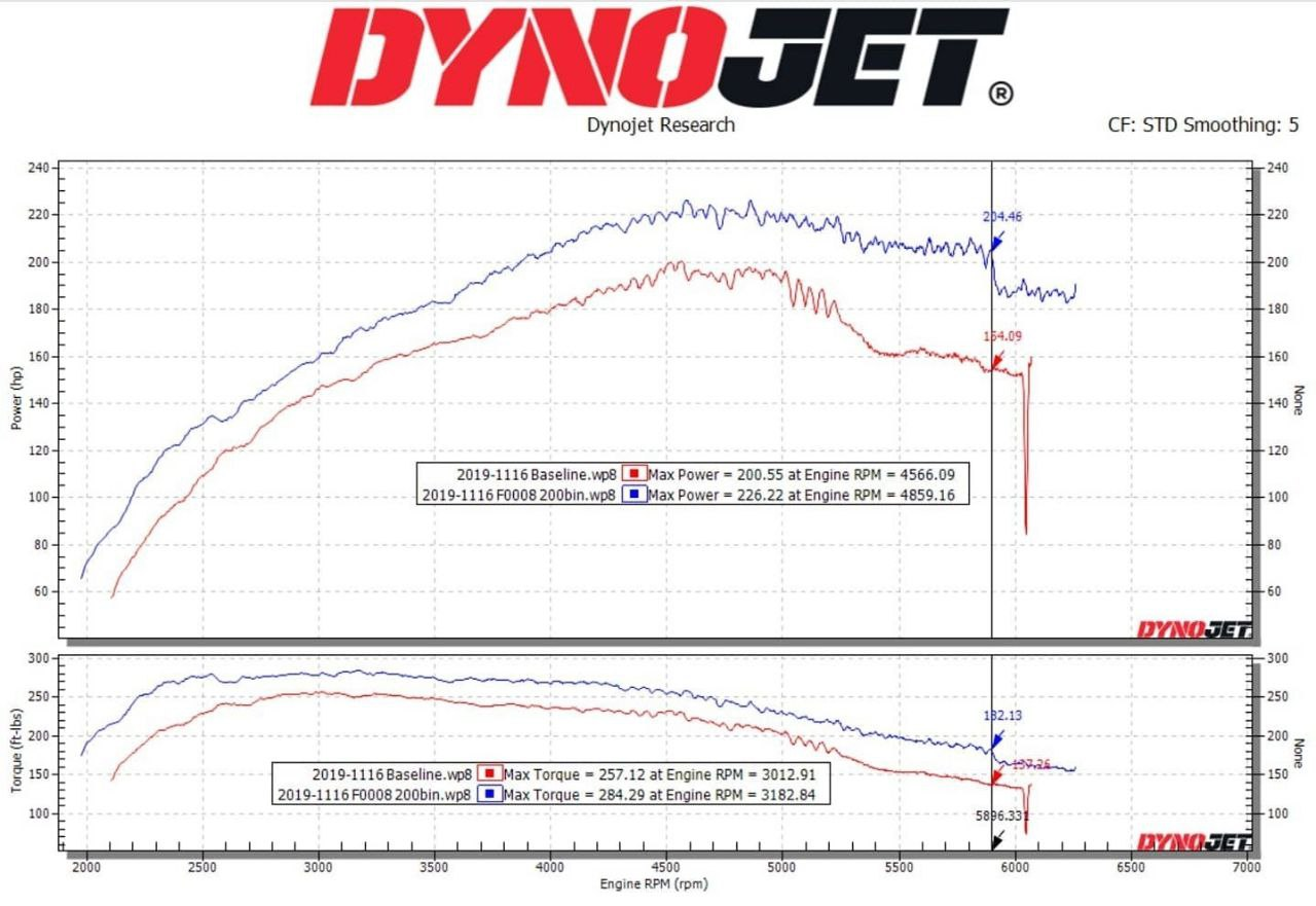

Yep, that does sound like my experience. I still can't think of a clear explanation for why my NX's low/mid-range dipped after the FTP charge pipe installation, when the inlet and outlet both retain factory dimensions. Higher volume > lower velocity, perhaps?
OrangeVirus had to modify their tune to bring power in that zone back to former levels. Below is the post-tune dyno for my NX. The engine did get stronger at the upper-end of the rev range. Since I haven't seen gains of 50awhp from other tuned, stock 8AR vehicles, I'm inclined to pin the gain on the increased charge pipe volume.
All of this was observed with the mindset that the charge pipe replacement is nothing more than a cosmetic mod. The gains were definitely a pleasant surprise after the low/mid-range was sorted out. If you want more turbo sounds, an intake and a turbo muffler delete might yield more than a charge pipe replacement ever will.
