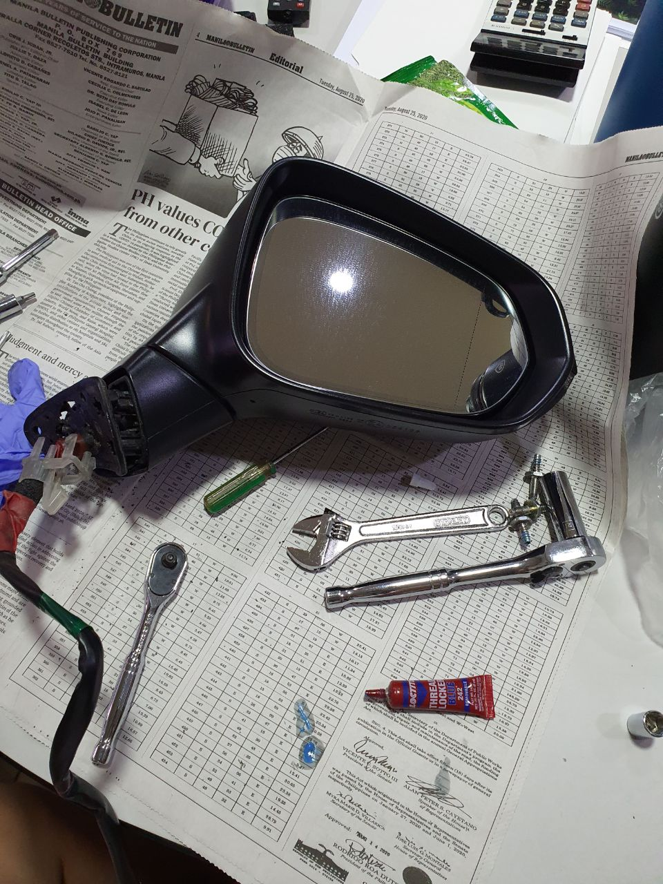

From: MNL PH
Post
I recently fixed mine by removing both side mirrors and thread-locking and re-tightening the three Torx 20 or 25 screws that join the housings to their bases. My issue was the floppy mirror housings on solid bases though, not really much of the vibration caused by thin sheet metal, which would cause the side mirror bases to move as well, as others have referred to in earlier replies.
