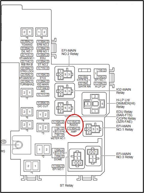

Can someone please tell me where to find the fuses for the radio? I cannot find a good diagram online and i dont see one clearly marked as radio under the dash or in the engine compartment.
incidently, i am having the blank screen deal. I have read the threads, tried the battery reset and didnt work. Backup camera and screen working just fine. Refuse to go to Lexus for service and pay for them to try to get me to replace expensive radio. Want to check what i can before i look for an aftermarket replacement.

Engine compartment; left side. May be different if you have factory NAV or premium audio system.

I added pics. Yes mine has Nav. Not same as what you show, sadly.
again, which is for radio and/or amplifier?

Your photo shows the right (passenger on a USA vehicle) side fuse/relay, not the left (driver) side.
I also have a 2019 NX300 with NAV and the Radio (15A; blue color) and Amp (30A; green) fuses are as shown in the Post #2 drawing.
When viewing from the front of the vehicle with the hood open, the driver side will actually be on your right, which is a frequent cause of confusion .
