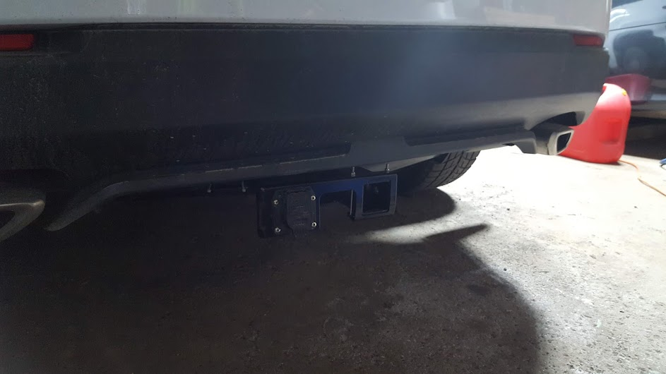

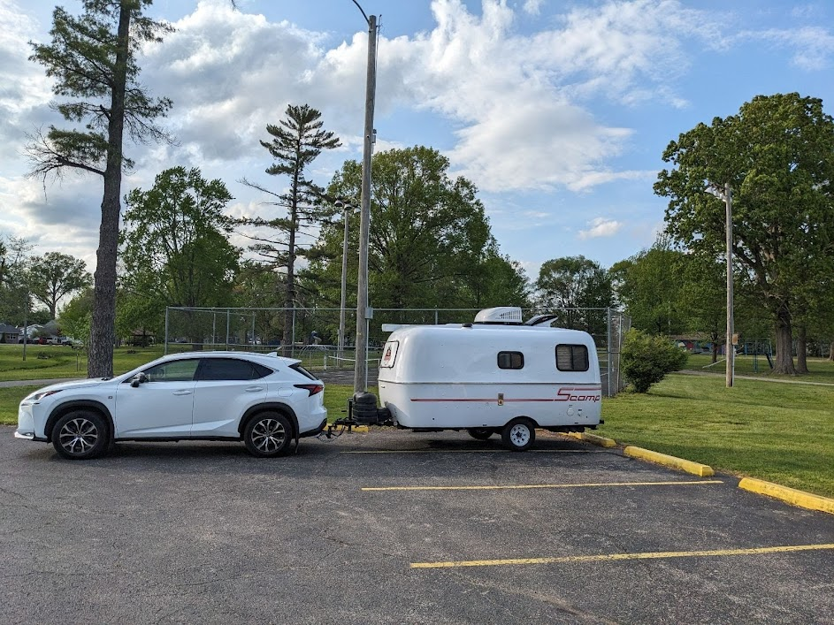

I wouldn't go oem for just a bike rack you will end up spending $1k+ just for a bicycle. Etrailer has curt or draw-tite hitches that will do the job for ~$200 and less than 30 min to install. I have a drawtite on for about 7 years now and going strong, the drawtite tucks up a bit better than the curt if you are going for a minimalistic look. Here are a few shots of the draw-tite, 20k miles and it has towed the camper up mountain passes in Banff Canada, through Big Bend in Texas and multiple trips to Phoenix from the Midwest
Thanks for your time and comment. Is this what you have?
https://www.draw-tite.com/product/75...receiver-black
Old Aug 21, 2025 | 10:59 AM
gompka's Avatar
gompka
iTrader: (6)
Joined: Sep 2002
Posts: 1,328
Likes: 81
Yes, that is the one I have.
