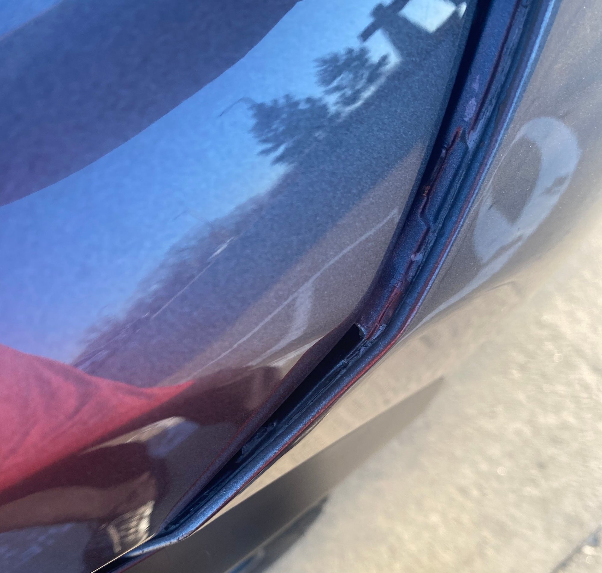

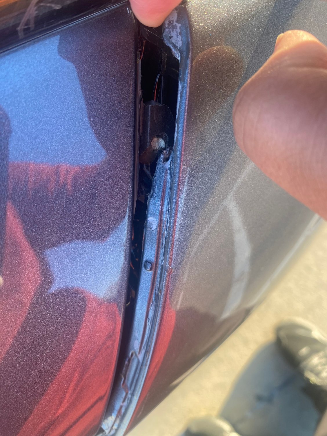

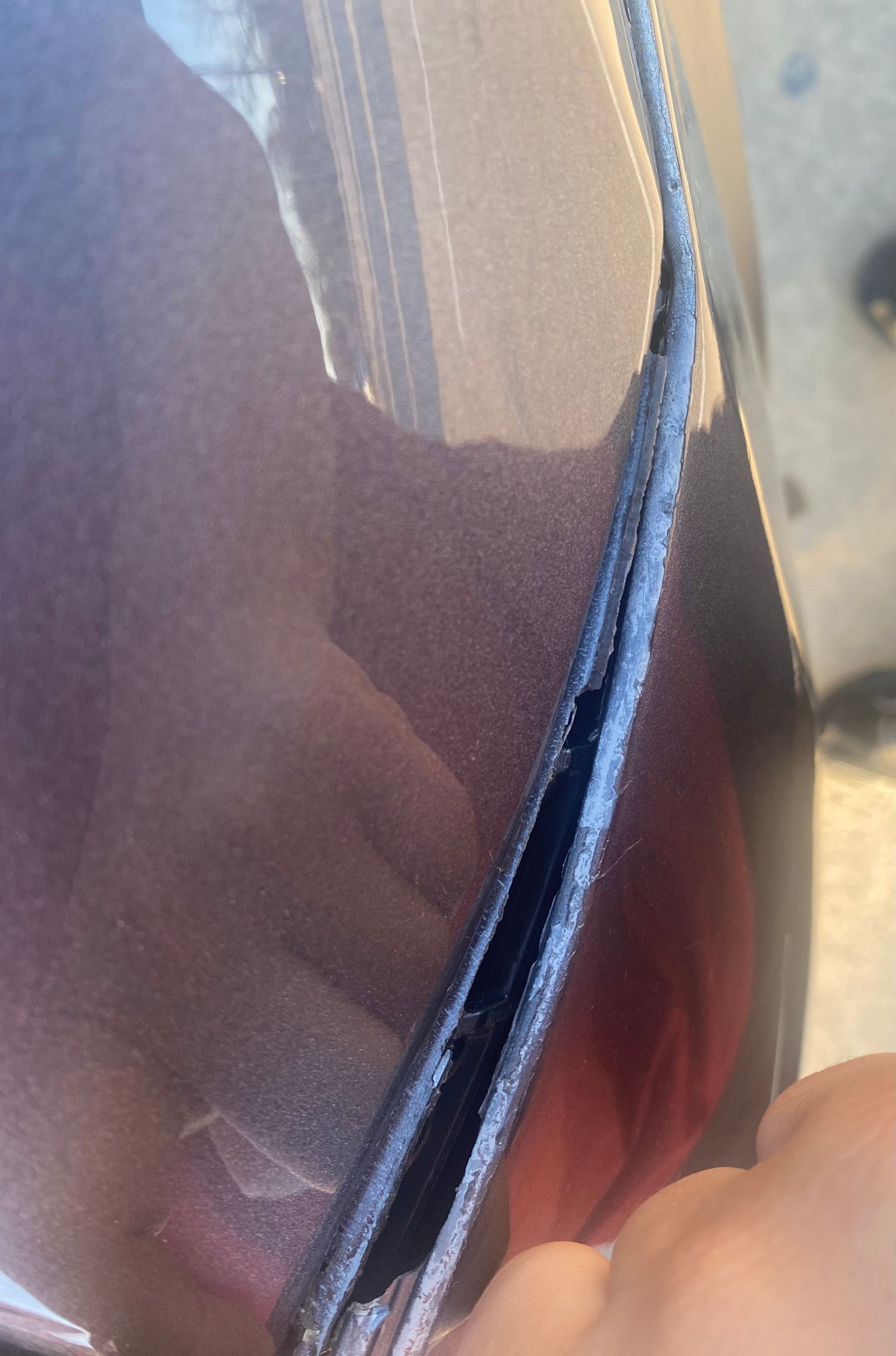

Hello everyone... I got a 2020 Lexus NX300. is there any way to fix this or need to change the bumper? Please feel to share some idea if you think of any..

That area is 'clipped' in via plastic (part of the bumper) and usually a few bolts.
If the clip area of the bumper is destroyed, you can always try to plasti-weld it. I've done it before with good results, but it all depends on the nature of everything.
You can also plastiweld a plastic piece to the inside of the bumper and zip tie it from inside to secure the fit, but that's up to you.

Thank you I will try that.
