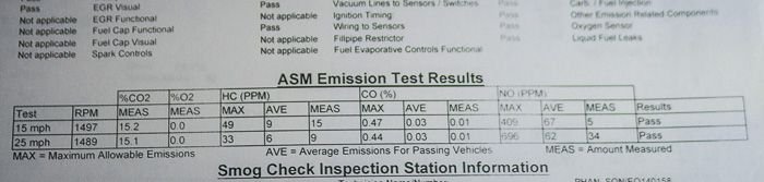

Default Adding the results of an 1990 LS400 here .....
Recently, an owner of 1900 LS400 w/120K miles posted his smog results from 2015:
Way lower in the HC and CO, but a bit higher in the NO dept.
In fact, it only went up from there - you can read more about his struggles with the CA smog test at his thread here:
https://www.clublexus.com/forums/ls-...les-1uzfe.html
