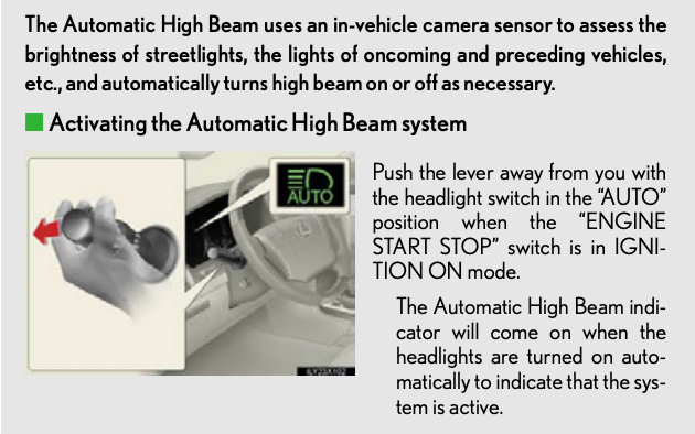

The manual said it does but I don't see the "Auto" in my high beam icon dashboard. Does that mean my particular model does not have automatic high beam or that I just don't know how to use it? Thanks!

The Automatic High Beam and accompanying dash icon only come on when the Low Beams
and their green lantern icon are on. Turn the turn signal stalk light control to the top to force
the Low Beams (and various marker lights) on and then press the left dash button with that
Auto High Beam icon. When the stalk is pushed toward the dash you will get both green icons.
Return the lights control to Auto (low beams) and in the daytime both green icons will turn off.
Note: the Auto High beams (and BSM the 2014's didn't have) have a 15 MPH threshold. When
slowing down on a dark road the High Beams will switch back to Low Beams. The green icon will
stay on but the actual high beams will be off.
