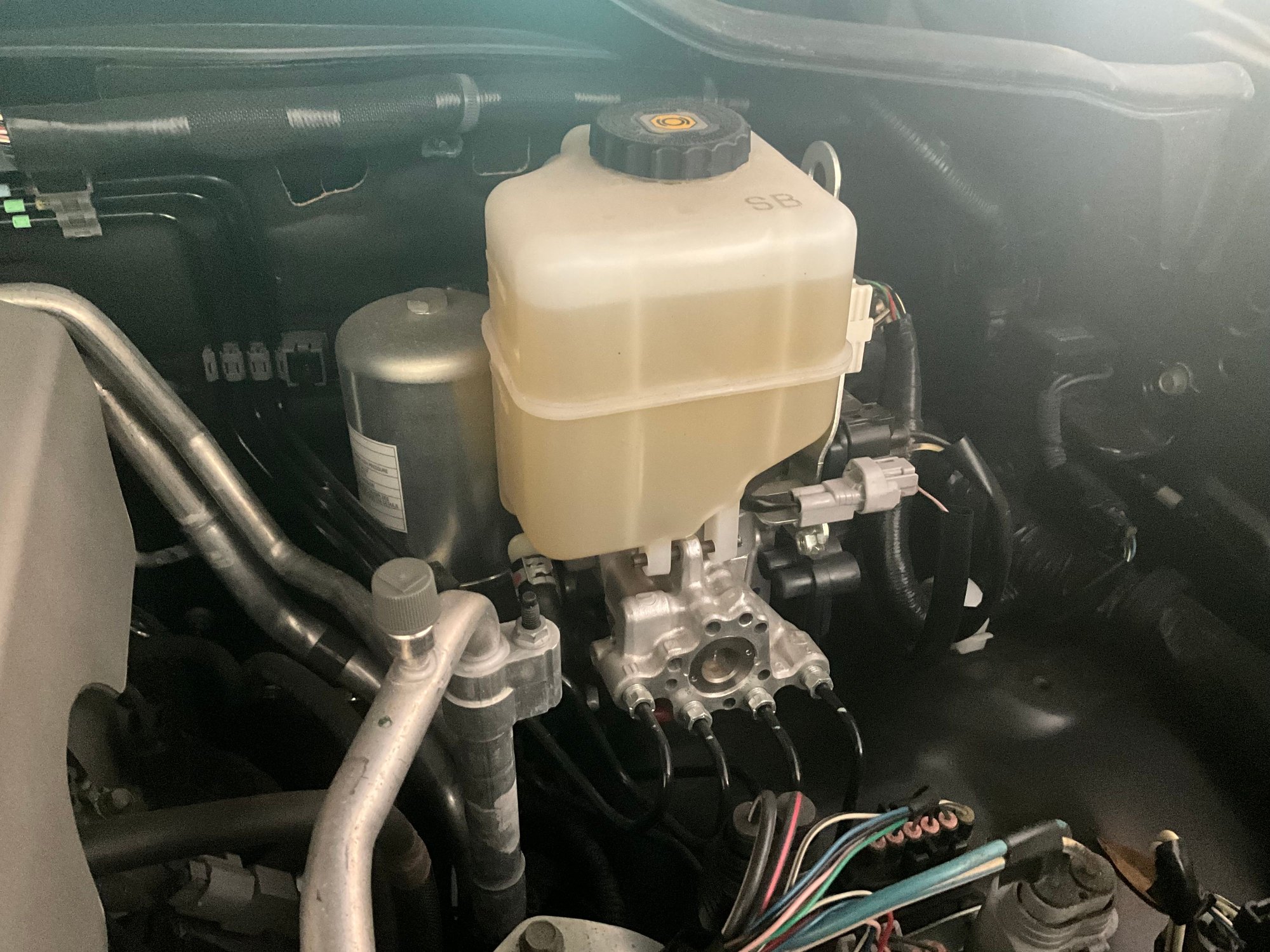

it really sounds like the brake system pump, i am all to familiar with the system on my SC430 and would assume it is the same on the LX570.
anyway, the pump pressurizes the accumulator, it is the round silver cylinder in the pic and is used for the ABS etc,
with that said. Next time you start the truck, have the hood open and jump out to check it. Might be easier with two people.
i just did it on mine and it was quieter and continuous until it pressurized the system.
BTW, you can do it with “KEY ON” Engine off, if you know what i mean.
