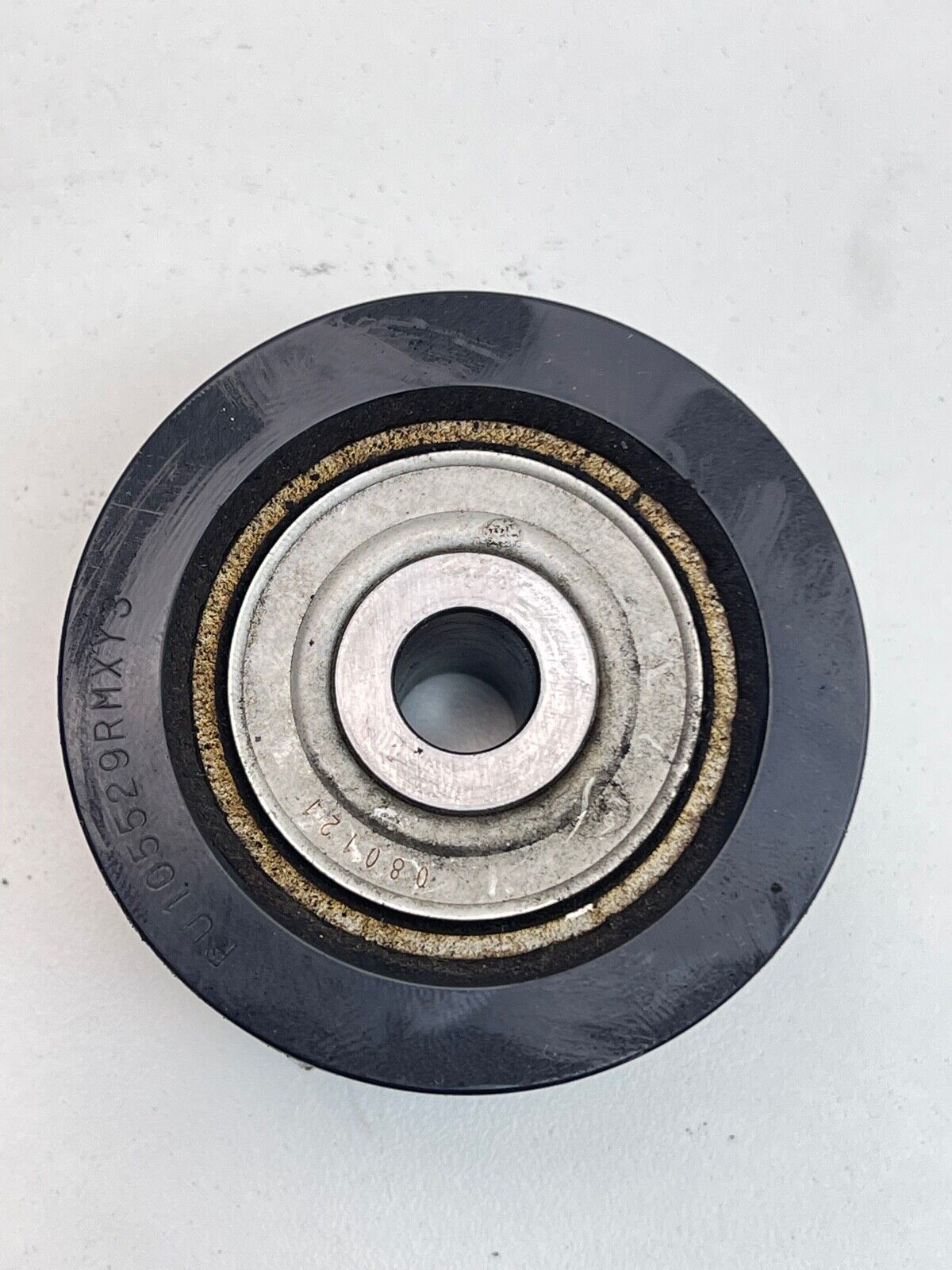

i know from experience replacing tons (on other cars) that pulleys can go bad early. lots of pressure and heat. and spinning fast at over 10,000+ RPM. dirt/dust picks away at the seals, causing oil to seep/evaporate out and dry out the bearings and eventually kill them. if you lose the dust cap it accelerates it. so it greatly depends on operating conditions. another thing that can kill them is if the tensioner is worn out or goes bad.
bearings live a hard life. here is how the pulley looks
