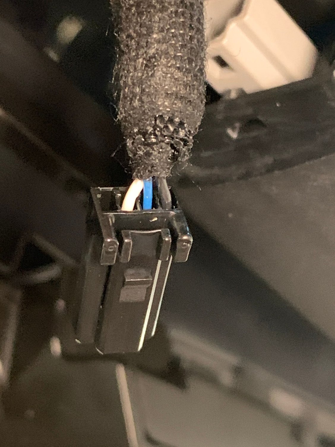

So I just installed my Escort Max 360 into my 2019 LS 500 and had to use the sensor power on the right side.
I had to figure out what wires were hot and ground. This is the harness I tapped into using wire taps I bought for the Escort.
For switched power, connect:
Black tap wire to the white harness wire
and
Red tap wire to the black harness wire
Works like a champ.
Hope this helps.
