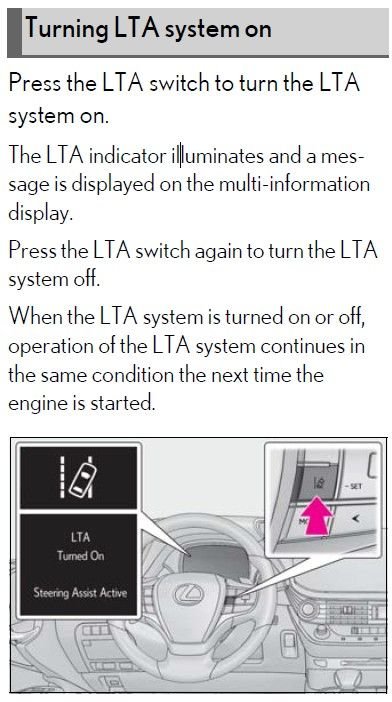

Regarding the steering wheel movement, your vehicle may be responding to activation of either a lane departure function or a lane centering function. Difficult to know which one you are experiencing without more information. I think, but am not positive, that both functions need to have Lane Tracing Assist (LTA) active. See second pic for how to deactivate LTA. If that doesn't resolve the issue, there are other settings you can change without going to a dealer that may help.

You can also use the button (switch) on the left side of the steering wheel to scroll thru various functions. It takes a little practice but is explained in your owner’s manual.
Lane Tracing Assist is a good safety feature, but if it annoys you just leave it turned off.
