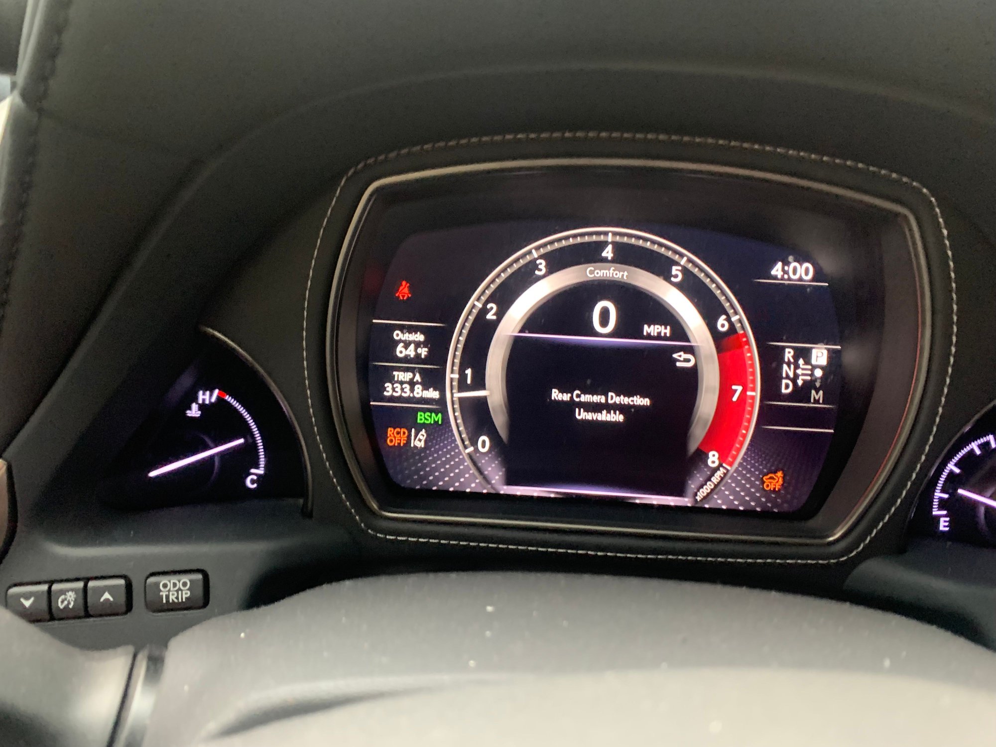

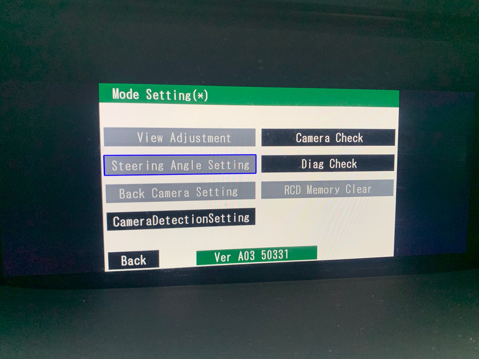

As the title states, I replaced the battery in my ‘19 LS500. Now I have a “Rear Camera Detection Unavailable” message. I have tried turning the steering wheel lock to lock and to drive the car straight at 22mph, per the manual. Neither have worked. I tried accessing the hidden service menu, but the “Steering Angle Setting” is greyed out and won’t let me access it. Anything else I can try?

Solved: use the instructions from the video below if you have the same issue.
