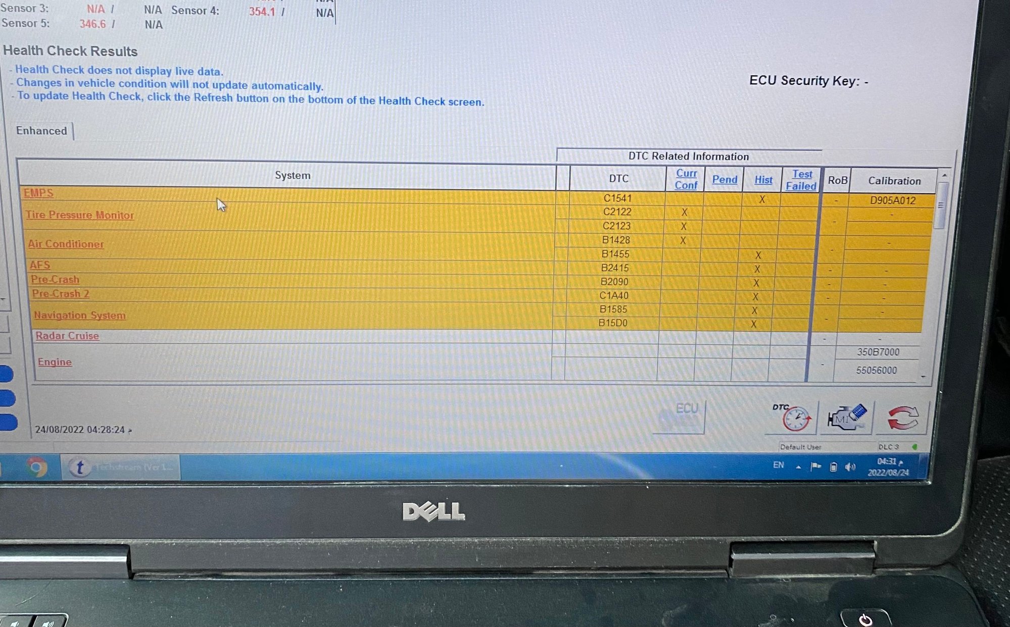

Do you have any error codes?

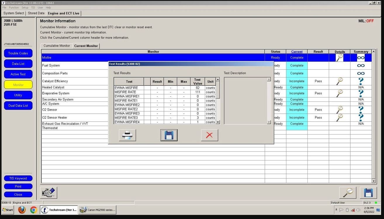

There are no engine related codes... Did you clean the MAF sensors? You have Techstream, you should try to monitor behavior of throttle body, timing, O2 sensors.

That idle looks normal to me. If you have the seat coolers / heaters turned on the elements can cycle on and off. Higher idle is likely the alternator keeping up with demand. If you really think there is an issue I would start by cleaning the maf sensors like Anfanger recommended. They could be to blame for your misfire too. I suspect a bad / weak 12v battery may be to blame for the idle.
Since you have techstream. The misfire can be narrowed down to exactly which cylinder. While running techstream go to this screen and attempt to reproduce the speed where you feel the misfire. If you are having misfires they will show up while your driving under the "current monitor" screen. I don't remember if you click on misfire details or summery but it's one of them. If you shut the car off before hooking up techsteam the smaller misfires aren't always saved. Make sure to scroll down to check all the cylinders. There are a few more pictures here.
