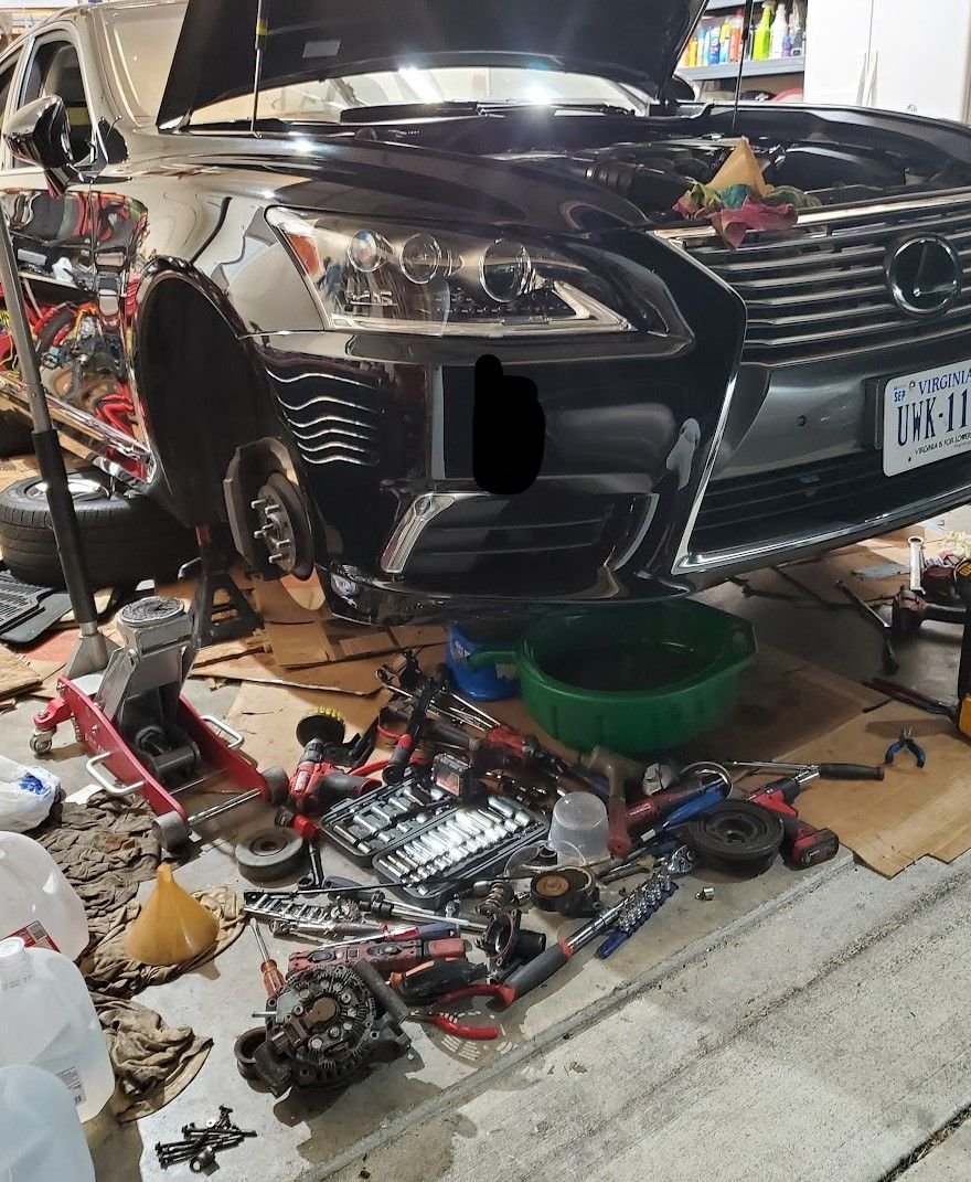

I did it a few years ago on a 2013 awd L
Wasn't bad, replaced all the belts and tensioner while I was at it.

How did you manage to do anything to that car with all those things taking up the floor space?

Picture was taken when most parts are installed.

Ok, I thought that guy must be really tall to work over the front of that car.
